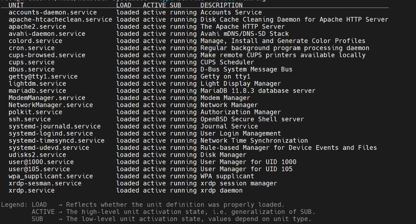

I’m installing MySQL/MariaDB and I can’t get any further, specifically the mysql_secure_installation bit. I’m following, as much as possible, the same install process used for a Raspberry Pi 5 where it worked, son

I’ve checked and Maria DB is running (see below).

mysql_secure_installation is the old name, try: mariadb-secure-installation.
https://mariadb.com/docs/server/clients-and-utilities/deployment-tools/mariadb-secure-installation
Thank you!
James
