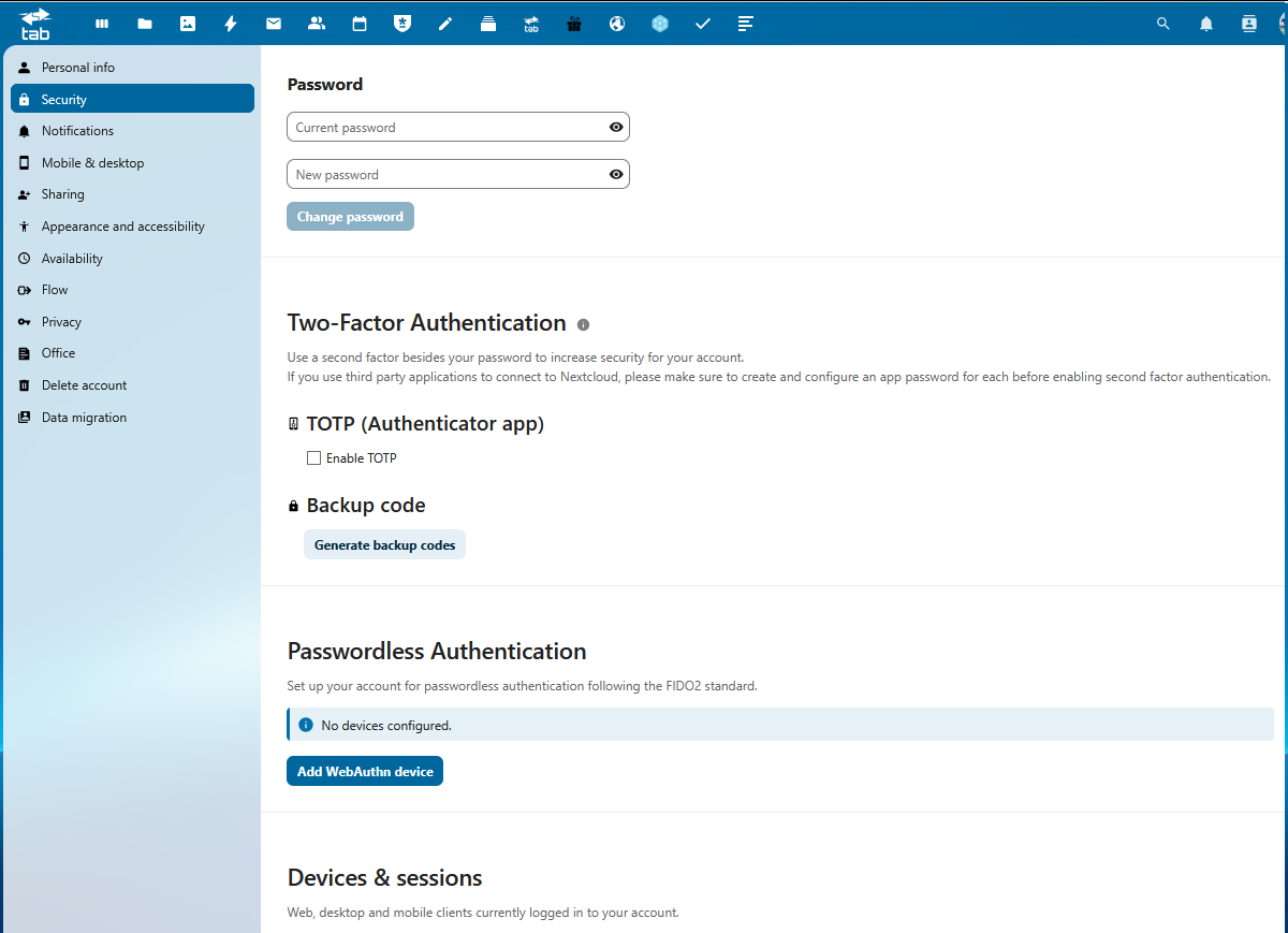

Here’s a screenshot of the settings page:
What you said about how it would normally work makes sense. I know for certain that “I” did not activate it and then deactivate it. There is no way I would have been that brain dead. And I would als0o have not missed a required decryption step.
