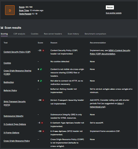

  • Using latest AIO 11.10.0 (nexctloud 31.0.9.1) with the caddy extension, no cloudflare or alike
When applying the mozilla http observatory report on my nextcloud instance I get a D rating.
  1. Go to https://developer.mozilla.org/en-US/observatory
  2. Scan your nextcloud AIO instance
  3. Check the result
Do I have to worry or are these security claims irrelevant?

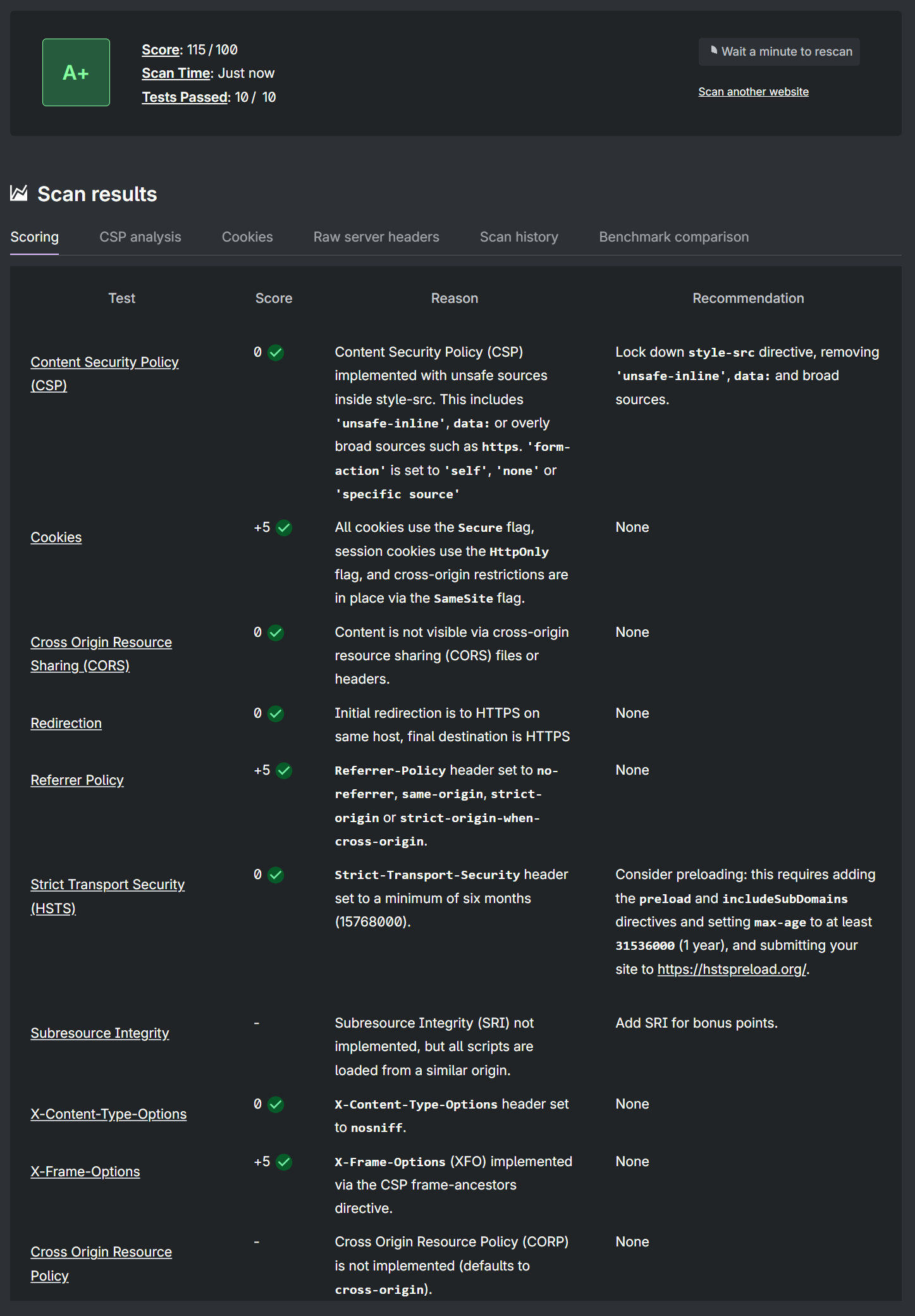

Hmm, for what it’s worth, I just scanned my AIO instance (which is web-facing and doesn’t use caddy) and received an A+ rating. I’m using NextCloud 32 and added https:// before my domain when starting the scan–perhaps that made a difference?
Update: I got an A+ when putting http:// before my site as well.

Hm, since I did not change anything, the only difference is the use of the caddy community container. Yet why should that make the assessment worse?
@szaimen could you please help me understand what I am doing wrong?
Tried without the caddy community extension and I get a A+. So according to the test the proxy decreases security.
Given the lack of any cookies or CSP headers (among others) in your original test results, seems something was definitely wrong. Are you sure it wasn’t hitting some old IP or something? Maybe show the Raw Server Headers tab - it may offer some clues.
I can reproduce it by enabling/disabling the caddy community extension. Thus an old IP cannot be the reason.
Hey, I just tested with the aio-caddy community container being enabled and I got an A+ result.
Do you have geoblocking active? In that case it might be possible that the remote server opening the side was not able to access the web site because it is not whitelisted afaik.
See my result:
