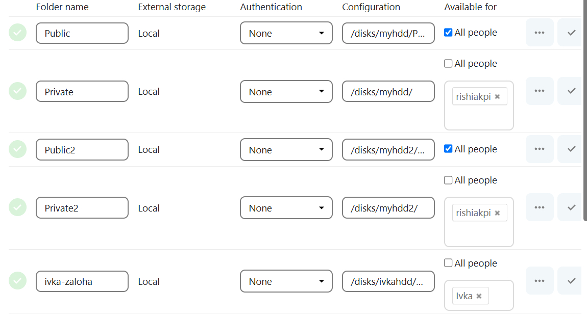

External folders
Problem
When I run docker-compose up -d my nextcloud works normally, I mounted external folders and I can go to /disks/myhdd for example in nextcloud bash. The problem occurs when I reboot the PI. Nextcloud should start automatically, everything loads and when I open nextcloud, I cant access my external folders. When I open nextcloud bash and try to navigate to the folder, for example /disks/myhdd i get Too many levels of symbolic links.
When I use docker restart nextcloud_app, it works. My question is, is there a possibility to mount my external HDDs to nextcloud so I won’t have to restart the container after every reboot? I don’t want to mount them each manually, because sometimes they wont be plugged in and nextcloud won’t start if I explicitly mount them in docker-compose and they are not plugged in. I also set enable sharing and previews on my external folders.
So my question is:
Is there a way to set this up so nextcloud starts on boot and has access to those HDDs, which are plugged in without failing because some of them may not be plugged in without the need to restart the container manually? Or am I doing something wrong?
