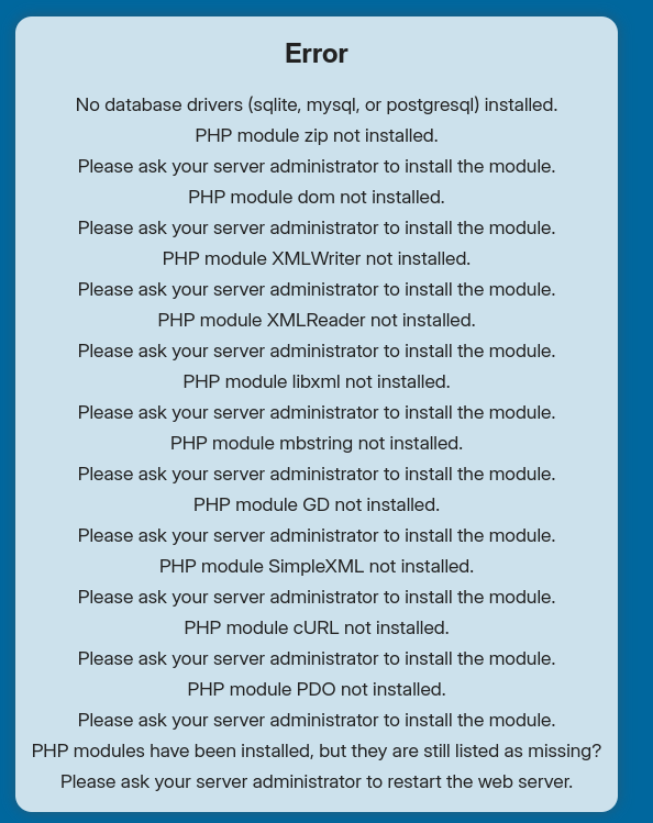

I did a fresh install on Raspberry Pi. I used this guide: https://pimylifeup.com/raspberry-pi-nextcloud-server/. Apache works fine, PHP was a problem (8.4 didn’t work, 8.2 does). I installed and removed a few times until I got it right. Now I can see the web UI from NextCloud (before, the PHP code was not rendered).
As in the guide, I made a nexcloud db and user. But I get:
I restarted the server a few times, also restarted the raspberry to be sure.

php -m gives:

Sorry, but Gus obviously missed telling you to read the nextcloud admin documentation and read carefully the error message: Believe it - you are your server administrator, you have to install the modules, it is not up to us. :grinning:
Nextcloud v31 is not available.
Please check your version.
There in step 4 you install the different php modules. The current raspbian (if it is based on debian bookworm) should then support php 8.2 out of the box (no external modules required).
With apt-cache search package-name you can search for packages (you can just search for parts of the name). Especially if tutorials are updated, package names can change slightly.
I don’t see curl, simplexml, …
so they are really missing. For the webinterface, make sure to restart apache (php -m from command line starts php directly, and the configuration might slightly differ from what is run through the webserver. In /etc/php*/, you have a cli config for command line, and apache2 for the apache module).
Aren’t these the required components:
$ sudo apt install php8.2-zip php8.2-xml php8.2-xmlwriter php8.2-xmlreader php8.2-mbstring php8.2-gd php8.2-curl php8.2-pdo php8.2-simplexml php8.2-dom php8.2-mysql

Everything is already installed? Except it says php8.2-xml is selected in stead of php8.2-xmlwriter, php8.2-xmlreader, php8.2-pdo, php8.2-simplexml and php8.2-dom…
I did that, and again after getting the error message:
$ sudo apt install php8.2 php8.2-gd php8.2-sqlite3 php8.2-curl php8.2-zip php8.2-xml php8.2-mbstring php8.2-mysql php8.2-bz2 php8.2-intl php8.2-smbclient php8.2-imap php8.2-gmp php8.2-bcmath libapache2-mod-php8.2

I checked it again, my NextCloud version is 30.0.4.
I tried with PHP versions 8.3 and 8.4, but if I tried those, an example.php page wouldn’t show in my browser (although if I looked at the source code, it was there).
I don’t understand to much of that, but since 8.2 is recommended in the guide I used, I went back to that version. Do you think the version of PHP can cause the error?
This file: /etc/php/8.2/cli/php.ini doesn’t exist on my system.
/etc/php/8.2/apache2/php.ini does.
I’m sorry, I don’t know what to do with this.
I clearly installed everything as in the guide, and also what is mentioned in this thread, but somehow the modules are not there…

I fixed the problem!
I’m not sure if this helped, but I upgraded again to PHP8.3.
Then I installed these extra parts:
sudo apt install php8.3-mysql php8.3-mbstring php8.3-gd php8.3-curl php8.3-zip php8.3-xml
Some of them where already there, but not all of them.
sudo apt install php8.3-zip php8.3-dom php8.3-xml php8.3-mbstring php8.3-gd php8.3-curl php8.3-simplexml
Again, some where there, but not all of them.
So some modules didn’t install by just following the guide.
I noticed, while switching from one PHP-version to another, that somehow, although you seem to copy-paste the same components, adding and removing, still leftovers stay and others don’t get installed fully. Strange.
I also did:
sudo a2dismod php8.2
sudo a2enmod php8.3
sudo systemctl restart apache2
