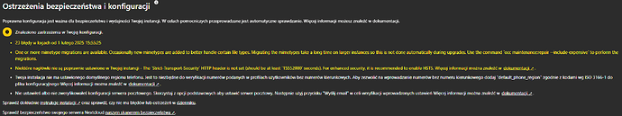

I am fresh after installing NextCloud on Unrid and I have the following message:
  • One or more mimetype migrations are available. Occasionally new mimetypes are added to better handle certain file types. Migrating the mimetypes take a long time on larger instances so this is not done automatically during upgrades. Use the command occ maintenance:repair --include-expensive to perform the migrations.
    Is there any way to fix it?
