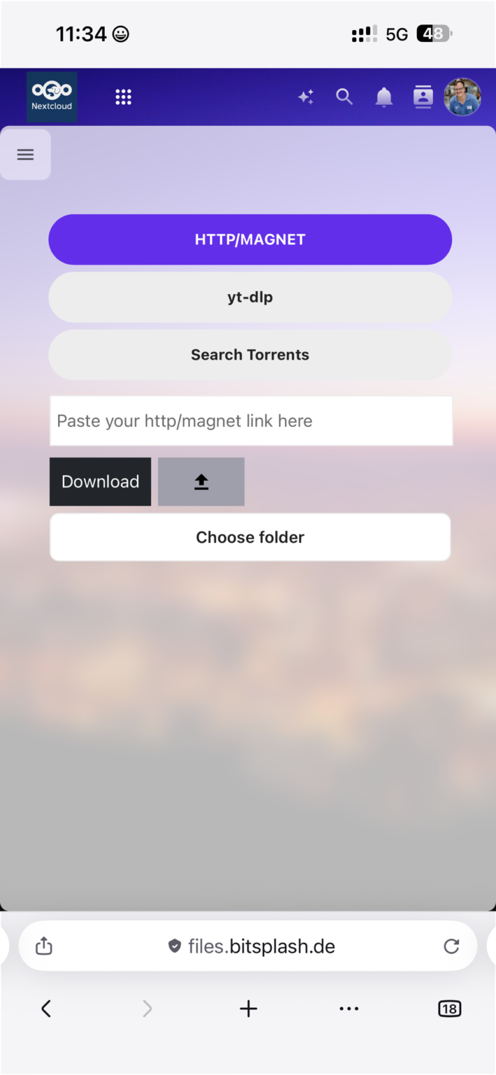

- Responsive navigation for phones and tablets
Mobile usability was especially important to me. I often want to start a download when I find something on my phone, so MediaFetch has a proper mobile navigation/drawer and was tested on an actual smartphone.
