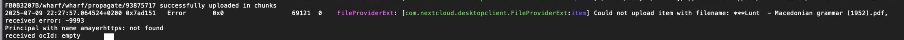

I wanted to let my dad use my Nextcloud instances so that he is no longer dependent on the big cloud providers. So far so good. Since he has a lot of files, he wanted to give the new VFS on Mac a try. We installed the app, he dropped a big chunk of his files (150GB maybe), and off it went. Started syncing, all good. Then, at some point it stopped. And since then, it seems half the files are on the server (I can confirm that), and half of the files are still local on the laptop. We can easily confirm that since some of the files you can open, and the other half it is spinning where it is supposed to sync from server, but it won’t. When starting Nextcloud, most of the times it turns into Application not responding after a while, the menu bar item does not show up anymore. Most of the times, there are entries in Console (from FileProviderExt), for example:
Or this:
There is others as well. If you want me to provide specific other data, just let me know.
