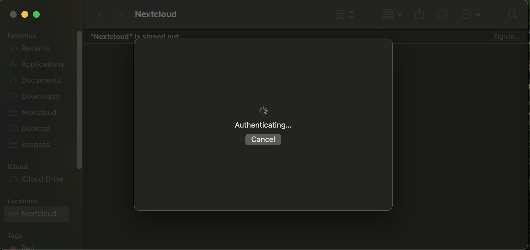

MAC VFS client keep hanging for "Authenticating..." in VFS synced folder
Env
  • macOS: 15.6.1
  • Nextcloud Desktop Client: 4.0.3
  • Server version: 32.0.1
Problem Description
When using the Nextcloud Desktop Client 4.0.3 on macOS 15.6.1 with Virtual Files (macOS File Provider) enabled, the client repeatedly enters an “Authenticating…” loop. after hanging for 30 mins, it give “There was a network connection error.“
Noted: My standard sync work normally, and I am using self hosted server with self-signed cert. I already try to remove and reinstall the client but not work.

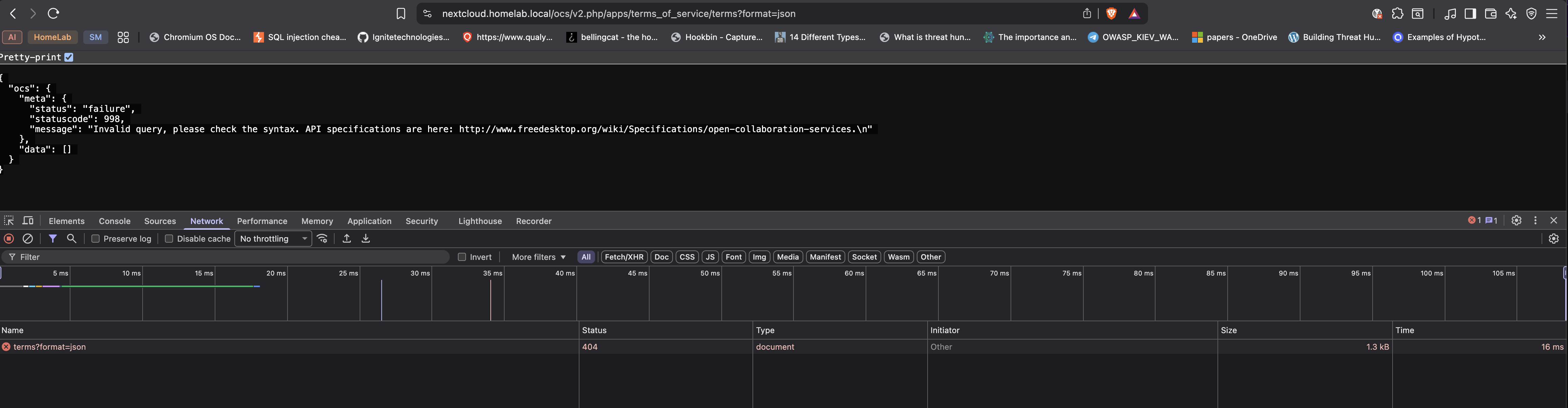

Network request error “Error transferring https://nextcloud.homelab.local/ocs/v2.php/apps/terms_of_service/terms?format=json - server replied: Not Found” HTTP status 404 httpReason “Not Found”
this is from your debug.log. Not sure why your Nextcloud server says that it is not found, perhaps some config not up to date? Not sure if this is related with other problems, but I’d try to go through the errors and try to solve them.

This is what I get from the 404 url, not sure what is it?
About The Finder Folder Is Not Loading NextCloud Content · Issue #7571 · nextcloud/desktop · GitHub , it look similar, but still not sure. I will try it.

This is what I get when try to authenticate.

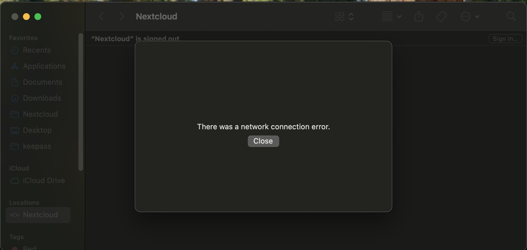

Noted: I experienced a self-signed certificate issue when adding account in the init setup, but resolved it by importing my self-signed CA into the keychain.
This appears to be a network issue. The HTTP calls to authenticate time out.
Please note that the file provider extension does not consider the network settings in the main app.
