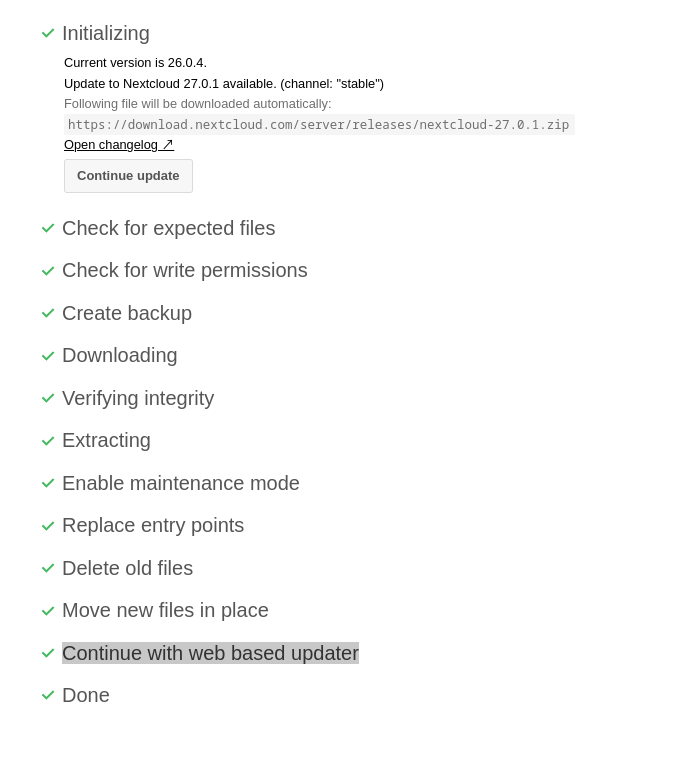

Hello, it looks like I messed up my Webupdater. I THINK this is what happened:
  • I started the updater in the Admin panel, then I lost the tab.
  • I ran occ update successfull to 26.0.4.
  • Later I found the tab and accidentally clicked “Continue with web based updater”
Now I want to update to 27.0.1, but my webupdater shows this
and exits back to the Admin panel as soon as I click “Continue update”
