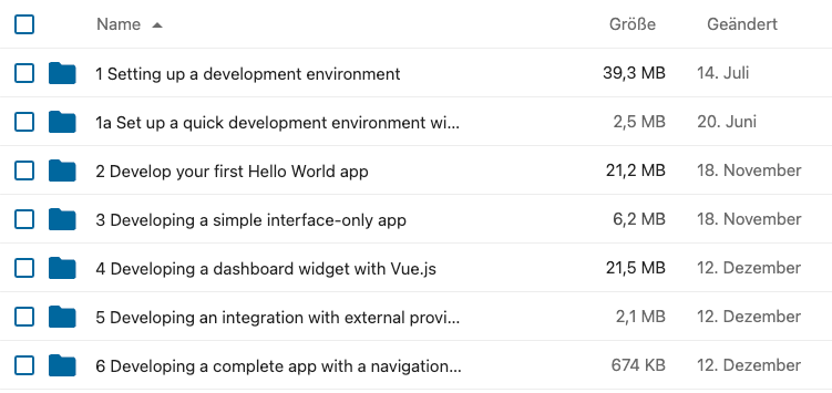

Hello everyone,
I’m new here and just getting started with programming apps.
I’m looking for a table-like component to display my data. Something like a file overview with headers would be okay (see attached picture). With basic features like sorting or filtering would be awesome.
I’ve checked the components listed in https://nextcloud-vue-components.netlify.app, but I haven’t found something that fits my needs.

To clarify my intention:
My institute uses Nextcloud for file storage. As an IT supporter with some full-stack development experience, I would like to improve efficiency and automation by developing a custom solution within the Nextcloud ecosystem.
What I want to achieve
  • A table-like component for displaying data
  • Custom group-by functionality (not necessarily configurable from the frontend)
  • Custom display logic, for example:
    • Masking sensitive data (e.g. ***) for users without sufficient permissions
    • Replacing certain values with links or other UI elements
What I have done so far
  • Followed the official app development tutorials up to “Developing a complete app with a navigation bar and database”
  • Tested standard HTML \<table\> elements, but the styling and usability are not optimal
  • Reviewed existing Tables apps in the Nextcloud App Store
What is failing
  • I am unsure whether there is an existing recommended table component or UI pattern within the Nextcloud ecosystem that would better suit this use case
What I expect from the community
  • Guidance on existing components, best practices, or recommendations, so I don’t reinvent the wheel unnecessarily
If this topic fits better in another category, please feel free to move it.
Best regards,
Zijian

Actually the Nextcloud files list table (with Name, Size, and Last modified as Headers) would actually be a good compromise. Unfortunately, it doesn’t seem to be offered in @nextcloud/vue for reuse in custom apps, which is a bit of a pity.
