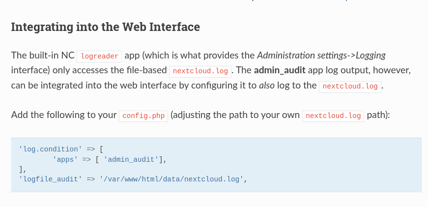

You can absolutely access the audit log from the Web interface. I think @wwe inadvertently posted a link to the ancient docs.
The newer ones have the process for integrating into the web interface:
(those are the docs for NC28/unreleased, but the audit log stuff documented in there is valid going back to >=NC24… and earlier even; I linked to these because the docs were just recently revised to better document how to configure the audit log).

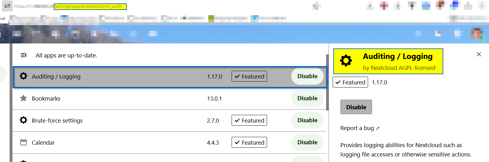

Logging is in version 1.17.0 active
If you go to Settings → Apps and search for “Audit” it’s definitely there to be installed as “Auditing / Logging”

You don’t need to go to the CLI to enable/configure audit logging, but you will have to modify your config.php and add the configuration I previously linked to.

No, negative. All what is offered is the defoult logging app.
And yes, there are tickboxes to be selcted, but I have selcetred them all.
In the description an admin-audit as an extra app is mentioned, but such
thingis not offered to me.

this is the one which is installed already and there is nothing else
But this does mainly crete endless list of php errors. Can not see other use of it nor any other app doing something more human readable

If you follow the process documented in the link we already provided, you’ll get what you’re looking for:
as I mentioned earlier, this instruction is of no use to me, as I can not enter any command via Cli.
Yes, I can download the log file and attempt to read it, but this is just an endless text with no particular meaning.
I can not add anything to any config.php.
An extra app called admin_audit is not listed for installation, thus no av to me.
Therefore I can not have the admin_audit as it is not offered for download and installation.
