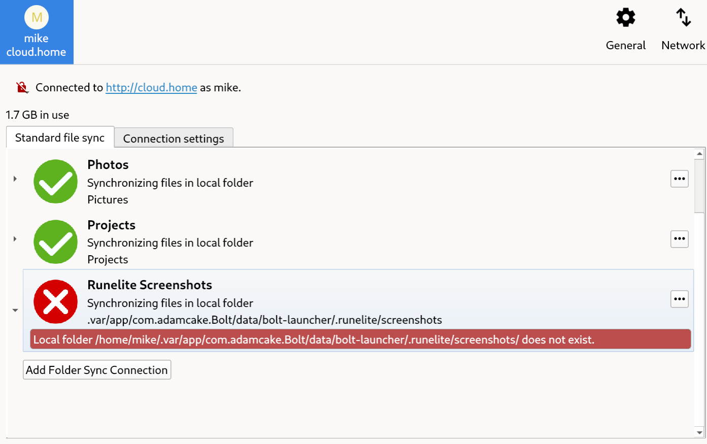

Folder sync connection is not working for certain paths on Fedora Linux. The path /.var/app/com.adamcake.Bolt/data/bolt-launcher/.runelite/screenshots seems to configure correctly, however it never syncs and presents an error upon restarting nextcloud desktop.
  1. Configure a folder sync connection with a path similar to above
  2. Observe the green check mark, indicating a successful configuration
  3. Notice that the contents of the folder are not syncing
  4. Restart Nextcloud desktop
  5. Observe the error in the screenshot above

I don’t think it’s a good idea to synchronise point folders or point files. But as I don’t use it myself, I don’t know how problematic it really is. Somehow the folder seems strange to me. What do you really want to synchronise? Why isn’t it completely normal in your HOME folder?
Hey there, thanks for the reply.
Background: I play a lot of Old School RuneScape, using the Runelite client via a Flatpak installation.
The folder in my original post is the screenshots directory for the game client. There aren’t any settings to update it, so I’m stuck with that folder path. The strange part is that it is working on my Desktop PC which is using Fedora 41 with KDE, but on my laptop (described above) it never works. It’s the same folder path on both computers.
