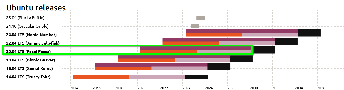

you do realize, that 20.04 has reached extended support recently? so unless you have extended support, there will certainly be packages that are not available for âfocalâ which may be necessary:
if youâre sure youâve done everything by the book and it just doesnât work, then consider upgrading the OS and try again. your best option in this case would be setting up a new server and migrating the snap to the new server: How to backup, restore and migrate Nextcloud snap
