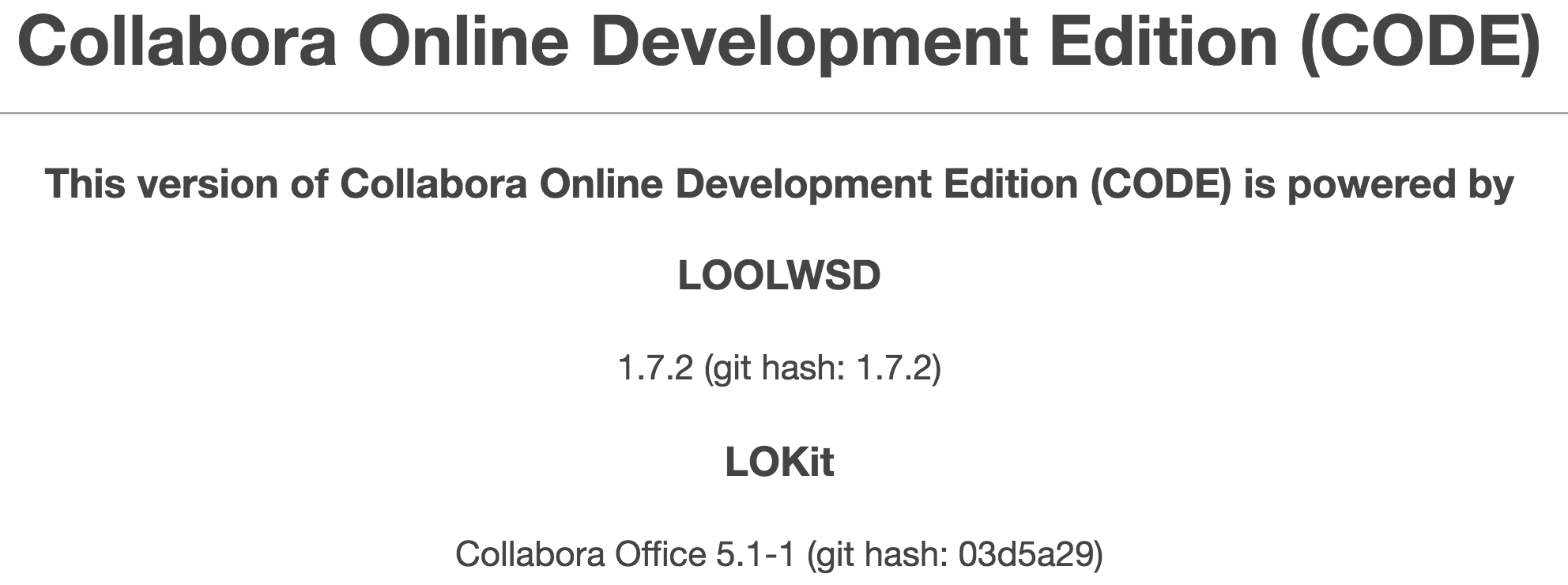

Regarding the connection error: Seems that the root cause is simple:
Turns out that the browser wants to connect to localhost.
In other words: This might work in the case browser and docker container run on the same box.
@rainer this looks like you probably haven’t configured your external URL in the admin area of your NC installation.
Eventually, I got it running :slight_smile:
What I did: started the container with
docker run -t -d -p 127.0.0.1:9980:9980 -e "domain=cloud\.example\.com" --restart always --cap-add MKNOD collabora/code
In the Collabora configuration in Nextcloud, URL to Collabora Online server is https://cloud.example.com/ (thanks, @jurgenhaas!
I think that’s all.
No need for additional certificates, the installation guide is wrong here.
Of course, you need to replace cloud.example.com with the name of your own nextcloud server.

@jospoortvliet Exactly what I had.
Resolution: make sure that your container has been started with -e "domain=cloud\.josandcamila\.com" - and the URL for the Collabora installation points to https://cloud.josandcamila.com/
I got it working with the tips aboce. What is strange though it takes a while to establish the connection. When I open a documents it takes up to 20 seconds.
Oh you’re so correct, I have it working now! So the domain to start the docker container with has to be the URL you run Nextcloud on, NOT the URL you run Collabora Online on… whoah.
Thanks a bunch! Yay for document editing in my own Nextcloud :smiley:
It works so far in Debian 8. Starting the document takes a few seconds . How could you speed this up? And how can you update the Docker container?
Thanks @rainer, that solved it for me, too!

When I check the URL https://cloud.wijman.me.uk/apps/richdocuments/wopi/files/349?access_token=IBiTRbdcEIWXbGM4cQ7SIX8ZclyYASxt manually I get the response:
{“BaseFileName”:“New Spreadsheet.ods”,“Size”:7130,“Version”:“0”}
Interesting, it says the app isn’t enabled in the error log… But it is and properly configured otherwise it wouldn’t get the URL, I bet.
Sorry, I have no clue what’s broken :frowning:
