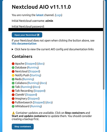

I installed Nextcloud AIO in a Debian LXC container running Proxmox using Docker Compose and am using a mount to my TrueNAS server for storage. This worked perfectly until last weekend, when suddenly the server wouldn’t even start Docker. A restart didn’t fix the problem. So, I simply updated Debian from version 12 to 13, since I wanted to upgrade to the newer version anyway. After restarting Docker, most of the containers from the Compose script worked again (Immich, Nginx, etc.), but Crafty and Nextcloud AIO were causing Compose to crash. So, I commented them out for now. I’ve now moved Crafty into another LXC container. However, Nextcloud is a different story. I want to use the AIO version because of its direct reverse proxy implementation and Notes functionality. But it’s not working there. Since I didn’t want to permanently affect my other containers, I looked into setting up another LXC container with Debian and Docker. I ran into problems there, as it wouldn’t even start. Then I tested it on a Raspberry Pi 5. I completely reinstalled Debian, installed Docker, and encountered problems and errors with Portainer, but ignored them. Starting Nextcloud AIO seemed to work until I got a “Slim Application Error.” The same thing happened with a Debian VM in Proxmox. Ideally, I’d like to just reinstall it in the first LXC container where all my other Docker containers are running and the Nextcloud configuration should still be there. But I’m just frustrated right now and don’t have the energy to figure this out on my own, so I’m asking for help. I’m somewhat tech-savvy, but due to personal commitments, I don’t have all day to dedicate to it.
Therefore, my main question is this: Which method do you recommend? Should I reinstall Nextcloud AIO on the LXC container with the other containers, use a separate LXC container, or use a VM with Docker or Nextcloud itself? Unfortunately, I don’t know what makes the most sense in my situation, and before I test something that might not be suitable for my server environment, I’d like to ask what the best approach is.
I will provide this later, depending on which method I am to use.
  • I’m using a Proxmox server with 6 cores and 12 threads. It has 64 GB of RAM and already has 6 LXC containers and 1 VM running (including the Docker container).

Further information I have that might help is that the LXC container is a privileged container (Unprivileged container: No).
Unfortunately, I can’t really help with that, but it looks like the system’s file ownership is somehow broken due to a UID/GID mapping issue. To me, this looks suspiciously like the kind of issue that may arise when running one container environment in another.
However, since it was working before the system upgrade, which normally also updates the Docker packages, I would try downgrading the Docker version. See: AIO NC does no longer start: Slim Application Error - #14 by bb77
If that doesn’t help, unfortunately I’m out of ideas, but perhaps someone else running AIO in a similar setup can suggest something.

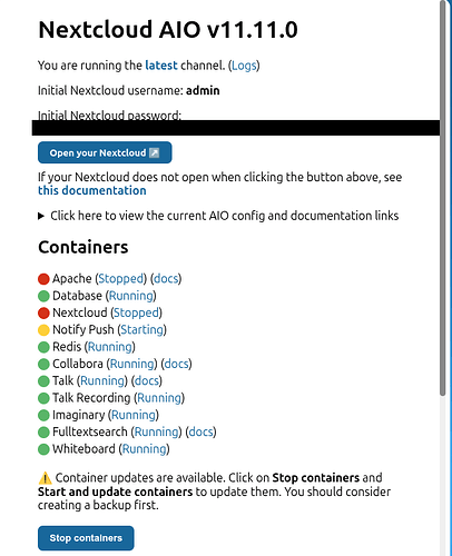

Okay, since it was recommended to me: I now have a Debian 12 VM with Docker. I ran Compose there and it worked. I was even able to select the containers to be used in the web UI. However, they apparently didn’t start correctly. Here are the logs:

database:
2025-11-14 01:05:52.127 CET [13] LOG:  all server processes terminated; reinitializing
2025-11-14 01:05:52.136 CET [703] LOG:  database system shutdown was interrupted; last known up at 2025-11-14 01:05:52 CET
2025-11-14 01:05:52.212 CET [703] LOG:  database system was not properly shut down; automatic recovery in progress
2025-11-14 01:05:52.215 CET [703] LOG:  redo starts at 0/1916428
2025-11-14 01:05:52.215 CET [703] LOG:  invalid record length at 0/1916460: expected at least 24, got 0
2025-11-14 01:05:52.215 CET [703] LOG:  redo done at 0/1916428 system usage: CPU: user: 0.00 s, system: 0.00 s, elapsed: 0.00 s
2025-11-14 01:05:52.220 CET [704] LOG:  checkpoint starting: end-of-recovery immediate wait
2025-11-14 01:05:52.220 CET [704] PANIC:  could not write to file "pg_logical/replorigin_checkpoint.tmp": No space left on device
2025-11-14 01:05:52.221 CET [13] LOG:  checkpointer process (PID 704) was terminated by signal 6: Aborted
2025-11-14 01:05:52.221 CET [13] LOG:  terminating any other active server processes

Trying to fix docker.sock permissions internally...
Creating docker group internally with id 994
Initial startup of Nextcloud All-in-One complete!
You should be able to open the Nextcloud AIO Interface now on port 8080 of this server!
E.g. https://internal.ip.of.this.server:8080
⚠️ Important: do always use an ip-address if you access this port and not a domain as HSTS might block access to it later!
If your server has port 80 and 8443 open and you point a domain to your server, you can get a valid certificate automatically by opening the Nextcloud AIO Interface via:
https://your-domain-that-points-to-this-server.tld:8443
/usr/lib/python3.12/site-packages/supervisor/options.py:13: UserWarning: pkg_resources is deprecated as an API. See https://setuptools.pypa.io/en/latest/pkg_resources.html. The pkg_resources package is slated for removal as early as 2025-11-30. Refrain from using this package or pin to Setuptools<81.
  import pkg_resources
[Thu Nov 13 23:53:14.007316 2025] [mpm_event:notice] [pid 149:tid 149] AH00489: Apache/2.4.65 (Unix) OpenSSL/3.5.4 configured -- resuming normal operations
[Thu Nov 13 23:53:14.007624 2025] [core:notice] [pid 149:tid 149] AH00094: Command line: 'httpd -D FOREGROUND'
[13-Nov-2025 23:53:14] NOTICE: fpm is running, pid 155
[13-Nov-2025 23:53:14] NOTICE: ready to handle connections
INF INF INF INF INF INF INF INF ts=1763077994.0297346 INF INF INF INF INF INF INF INF ts=1763077994.0297346 msg=maxprocs: Leaving GOMAXPROCS=4: CPU quota undefined
INF INF INF INF INF INF INF INF ts=1763077994.029876 INF INF INF INF INF INF INF INF ts=1763077994.029876 msg=GOMEMLIMIT is updated INF INF INF INF INF INF INF INF ts=1763077994.029876 INF INF INF INF INF INF INF INF ts=1763077994.029876 msg=GOMEMLIMIT is updated package=github.com/KimMachineGun/automemlimit/memlimit INF INF INF INF INF INF INF INF ts=1763077994.029876 INF INF INF INF INF INF INF INF ts=1763077994.029876 msg=GOMEMLIMIT is updated INF INF INF INF INF INF INF INF ts=1763077994.029876 INF INF INF INF INF INF INF INF ts=1763077994.029876 msg=GOMEMLIMIT is updated package=github.com/KimMachineGun/automemlimit/memlimit GOMEMLIMIT=7488641433 INF INF INF INF INF INF INF INF ts=1763077994.029876 INF INF INF INF INF INF INF INF ts=1763077994.029876 msg=GOMEMLIMIT is updated INF INF INF INF INF INF INF INF ts=1763077994.029876 INF INF INF INF INF INF INF INF ts=1763077994.029876 msg=GOMEMLIMIT is updated package=github.com/KimMachineGun/automemlimit/memlimit INF INF INF INF INF INF INF INF ts=1763077994.029876 INF INF INF INF INF INF INF INF ts=1763077994.029876 msg=GOMEMLIMIT is updated INF INF INF INF INF INF INF INF ts=1763077994.029876 INF INF INF INF INF INF INF INF ts=1763077994.029876 msg=GOMEMLIMIT is updated package=github.com/KimMachineGun/automemlimit/memlimit GOMEMLIMIT=7488641433 previous=9223372036854776000
INF INF INF INF INF INF INF INF ts=1763077994.029909 INF INF INF INF INF INF INF INF ts=1763077994.029909 msg=using config from file INF INF INF INF INF INF INF INF ts=1763077994.029909 INF INF INF INF INF INF INF INF ts=1763077994.029909 msg=using config from file file=/Caddyfile
INF INF INF INF INF INF INF INF ts=1763077994.03113 INF INF INF INF INF INF INF INF ts=1763077994.03113 msg=adapted config to JSON INF INF INF INF INF INF INF INF ts=1763077994.03113 INF INF INF INF INF INF INF INF ts=1763077994.03113 msg=adapted config to JSON adapter=caddyfile
INF INF INF INF INF INF INF INF ts=1763077994.0328195 INF INF INF INF INF INF INF INF ts=1763077994.0328195 msg=serving initial configuration
NOTICE: PHP message: Could not start domaincheck container: Client error: `POST http://127.0.0.1/v1.41/networks/frontend_net/connect` resulted in a `404 Not Found` response:
network frontend_net not found
NOTICE: PHP message: The response of the connection attempt to "https://-------------:443" was: error code: 502
NOTICE: PHP message: Expected was: f9005c500509b0f42c8dc954244f0fd69ca75ee8e59d0bf0
NOTICE: PHP message: The error message was:
NOTICE: PHP message: Please follow https://github.com/nextcloud/all-in-one/blob/main/reverse-proxy.md#how-to-debug in order to debug things!
NOTICE: PHP message: Slim Application Error
Type: Exception
Code: 0
Message: Could not create container nextcloud-aio-clamav: {"message":"failed to copy files: write /var/lib/docker/volumes/nextcloud_aio_clamav/_data/main.cvd: no space left on device"}
File: /var/www/docker-aio/php/src/Docker/DockerActionManager.php
9
Trace: #0 /var/www/docker-aio/php/src/Controller/DockerController.php(40): AIO\Docker\DockerActionManager->CreateContainer(Object(AIO\Container\Container))
#1 /var/www/docker-aio/php/src/Controller/DockerController.php(27): AIO\Controller\DockerController->PerformRecursiveContainerStart('nextcloud-aio-c...', true)
#2 /var/www/docker-aio/php/src/Controller/DockerController.php(27): AIO\Controller\DockerController->PerformRecursiveContainerStart('nextcloud-aio-n...', true)
#3 /var/www/docker-aio/php/src/Controller/DockerController.php(221): AIO\Controller\DockerController->PerformRecursiveContainerStart('nextcloud-aio-a...', true)
#4 /var/www/docker-aio/php/src/Controller/DockerController.php(201): AIO\Controller\DockerController->startTopContainer(true)
#5 /var/www/docker-aio/php/vendor/slim/slim/Slim/Handlers/Strategies/RequestResponse.php(39): AIO\Controller\DockerController->StartContainer(Object(GuzzleHttp\Psr7\ServerRequest), Object(GuzzleHttp\Psr7\Response), Array)
#6 /var/www/docker-aio/php/vendor/slim/slim/Slim/Routing/Route.php(362): Slim\Handlers\Strategies\RequestResponse->__invoke(Array, Object(GuzzleHttp\Psr7\ServerRequest), Object(GuzzleHttp\Psr7\Response), Array)
#7 /var/www/docker-aio/php/vendor/slim/slim/Slim/MiddlewareDispatcher.php(73): Slim\Routing\Route->handle(Object(GuzzleHttp\Psr7\ServerRequest))
#8 /var/www/docker-aio/php/vendor/slim/slim/Slim/MiddlewareDispatcher.php(73): Slim\MiddlewareDispatcher->handle(Object(GuzzleHttp\Psr7\ServerRequest))
#9 /var/www/docker-aio/php/vendor/slim/slim/Slim/Routing/Route.php(321): Slim\MiddlewareDispatcher->handle(Object(GuzzleHttp\Psr7\ServerRequest))
#10 /var/www/docker-aio/php/vendor/slim/slim/Slim/Routing/RouteRunner.php(74): Slim\Routing\Route->run(Object(GuzzleHttp\Psr7\ServerRequest))
#11 /var/www/docker-aio/php/vendor/slim/csrf/src/Guard.php(482): Slim\Routing\RouteRunner->handle(Object(GuzzleHttp\Psr7\ServerRequest))
#12 /var/www/docker-aio/php/vendor/slim/slim/Slim/MiddlewareDispatcher.php(178): Slim\Csrf\Guard->process(Object(GuzzleHttp\Psr7\ServerRequest), Object(Slim\Routing\RouteRunner))
#13 /var/www/docker-aio/php/vendor/slim/twig-view/src/TwigMiddleware.php(117): Psr\Http\Server\RequestHandlerInterface@anonymous->handle(Object(GuzzleHttp\Psr7\ServerRequest))
#14 /var/www/docker-aio/php/vendor/slim/slim/Slim/MiddlewareDispatcher.php(129): Slim\Views\TwigMiddleware->process(Object(GuzzleHttp\Psr7\ServerRequest), Object(Psr\Http\Server\RequestHandlerInterface@anonymous))
#15 /var/www/docker-aio/php/src/Middleware/AuthMiddleware.php(36): Psr\Http\Server\RequestHandlerInterface@anonymous->handle(Object(GuzzleHttp\Psr7\ServerRequest))
#16 /var/www/docker-aio/php/vendor/slim/slim/Slim/MiddlewareDispatcher.php(283): AIO\Middleware\AuthMiddleware->__invoke(Object(GuzzleHttp\Psr7\ServerRequest), Object(Psr\Http\Server\RequestHandlerInterface@anonymous))
#17 /var/www/docker-aio/php/vendor/slim/slim/Slim/Middleware/ErrorMiddleware.php(77): Psr\Http\Server\RequestHandlerInterface@anonymous->handle(Object(GuzzleHttp\Psr7\ServerRequest))
#18 /var/www/docker-aio/php/vendor/slim/slim/Slim/MiddlewareDispatcher.php(129): Slim\Middleware\ErrorMiddleware->process(Object(GuzzleHttp\Psr7\ServerRequest), Object(Psr\Http\Server\RequestHandlerInterface@anonymous))
#19 /var/www/docker-aio/php/vendor/slim/slim/Slim/MiddlewareDispatcher.php(73): Psr\Http\Server\RequestHandlerInterface@anonymous->handle(Object(GuzzleHttp\Psr7\ServerRequest))
#20 /var/www/docker-aio/php/vendor/slim/slim/Slim/App.php(209): Slim\MiddlewareDispatcher->handle(Object(GuzzleHttp\Psr7\ServerRequest))
#21 /var/www/docker-aio/php/vendor/slim/slim/Slim/App.php(193): Slim\App->handle(Object(GuzzleHttp\Psr7\ServerRequest))
#22 /var/www/docker-aio/php/public/index.php(198): Slim\App->run()
#23 {main}
Tips: To display error details in HTTP response set "displayErrorDetails" to true in the ErrorHandler constructor.
9
#1 /var/www/docker-aio/php/src/Controller/DockerController.php(27): AIO\Controller\DockerController->PerformRecursiveContainerStart('nextcloud-aio-n...', true)
#2 /var/www/docker-aio/php/src/Controller/DockerController.php(221): AIO\Controller\DockerController->PerformRecursiveContainerStart('nextcloud-aio-a...', true)
#3 /var/www/docker-aio/php/src/Controller/DockerController.php(201): AIO\Controller\DockerController->startTopContainer(true)
#4 /var/www/docker-aio/php/vendor/slim/slim/Slim/Handlers/Strategies/RequestResponse.php(39): AIO\Controller\DockerController->StartContainer(Object(GuzzleHttp\Psr7\ServerRequest), Object(GuzzleHttp\Psr7\Response), Array)
#5 /var/www/docker-aio/php/vendor/slim/slim/Slim/Routing/Route.php(362): Slim\Handlers\Strategies\RequestResponse->__invoke(Array, Object(GuzzleHttp\Psr7\ServerRequest), Object(GuzzleHttp\Psr7\Response), Array)
#6 /var/www/docker-aio/php/vendor/slim/slim/Slim/MiddlewareDispatcher.php(73): Slim\Routing\Route->handle(Object(GuzzleHttp\Psr7\ServerRequest))
#7 /var/www/docker-aio/php/vendor/slim/slim/Slim/MiddlewareDispatcher.php(73): Slim\MiddlewareDispatcher->handle(Object(GuzzleHttp\Psr7\ServerRequest))
#8 /var/www/docker-aio/php/vendor/slim/slim/Slim/Routing/Route.php(321): Slim\MiddlewareDispatcher->handle(Object(GuzzleHttp\Psr7\ServerRequest))
#9 /var/www/docker-aio/php/vendor/slim/slim/Slim/Routing/RouteRunner.php(74): Slim\Routing\Route->run(Object(GuzzleHttp\Psr7\ServerRequest))
#10 /var/www/docker-aio/php/vendor/slim/csrf/src/Guard.php(482): Slim\Routing\RouteRunner->handle(Object(GuzzleHttp\Psr7\ServerRequest))
#11 /var/www/docker-aio/php/vendor/slim/slim/Slim/MiddlewareDispatcher.php(178): Slim\Csrf\Guard->process(Object(GuzzleHttp\Psr7\ServerRequest), Object(Slim\Routing\RouteRunner))
#12 /var/www/docker-aio/php/vendor/slim/twig-view/src/TwigMiddleware.php(117): Psr\Http\Server\RequestHandlerInterface@anonymous->handle(Object(GuzzleHttp\Psr7\ServerRequest))
#13 /var/www/docker-aio/php/vendor/slim/slim/Slim/MiddlewareDispatcher.php(129): Slim\Views\TwigMiddleware->process(Object(GuzzleHttp\Psr7\ServerRequest), Object(Psr\Http\Server\RequestHandlerInterface@anonymous))
#14 /var/www/docker-aio/php/src/Middleware/AuthMiddleware.php(36): Psr\Http\Server\RequestHandlerInterface@anonymous->handle(Object(GuzzleHttp\Psr7\ServerRequest))
#15 /var/www/docker-aio/php/vendor/slim/slim/Slim/MiddlewareDispatcher.php(283): AIO\Middleware\AuthMiddleware->__invoke(Object(GuzzleHttp\Psr7\ServerRequest), Object(Psr\Http\Server\RequestHandlerInterface@anonymous))
#16 /var/www/docker-aio/php/vendor/slim/slim/Slim/Middleware/ErrorMiddleware.php(77): Psr\Http\Server\RequestHandlerInterface@anonymous->handle(Object(GuzzleHttp\Psr7\ServerRequest))
#17 /var/www/docker-aio/php/vendor/slim/slim/Slim/MiddlewareDispatcher.php(129): Slim\Middleware\ErrorMiddleware->process(Object(GuzzleHttp\Psr7\ServerRequest), Object(Psr\Http\Server\RequestHandlerInterface@anonymous))
#18 /var/www/docker-aio/php/vendor/slim/slim/Slim/MiddlewareDispatcher.php(73): Psr\Http\Server\RequestHandlerInterface@anonymous->handle(Object(GuzzleHttp\Psr7\ServerRequest))
#19 /var/www/docker-aio/php/vendor/slim/slim/Slim/App.php(209): Slim\MiddlewareDispatcher->handle(Object(GuzzleHttp\Psr7\ServerRequest))
#20 /var/www/docker-aio/php/vendor/slim/slim/Slim/App.php(193): Slim\App->handle(Object(GuzzleHttp\Psr7\ServerRequest))
#21 /var/www/docker-aio/php/public/index.php(198): Slim\App->run()
#22 {main}
[15-Nov-2025 16:32:04] NOTICE: Terminating ...
[15-Nov-2025 16:32:04] NOTICE: exiting, bye-bye!
[Sat Nov 15 16:32:06.993956 2025] [mpm_event:notice] [pid 147:tid 147] AH00491: caught SIGTERM, shutting down
INF INF INF INF INF INF INF INF ts=1763227958.0534937 INF INF INF INF INF INF INF INF ts=1763227958.0534937 msg=maxprocs: Leaving GOMAXPROCS=4: CPU quota undefined
INF INF INF INF INF INF INF INF ts=1763227958.0541925 INF INF INF INF INF INF INF INF ts=1763227958.0541925 msg=GOMEMLIMIT is updated INF INF INF INF INF INF INF INF ts=1763227958.0541925 INF INF INF INF INF INF INF INF ts=1763227958.0541925 msg=GOMEMLIMIT is updated package=github.com/KimMachineGun/automemlimit/memlimit INF INF INF INF INF INF INF INF ts=1763227958.0541925 INF INF INF INF INF INF INF INF ts=1763227958.0541925 msg=GOMEMLIMIT is updated INF INF INF INF INF INF INF INF ts=1763227958.0541925 INF INF INF INF INF INF INF INF ts=1763227958.0541925 msg=GOMEMLIMIT is updated package=github.com/KimMachineGun/automemlimit/memlimit GOMEMLIMIT=12573359308 INF INF INF INF INF INF INF INF ts=1763227958.0541925 INF INF INF INF INF INF INF INF ts=1763227958.0541925 msg=GOMEMLIMIT is updated INF INF INF INF INF INF INF INF ts=1763227958.0541925 INF INF INF INF INF INF INF INF ts=1763227958.0541925 msg=GOMEMLIMIT is updated package=github.com/KimMachineGun/automemlimit/memlimit INF INF INF INF INF INF INF INF ts=1763227958.0541925 INF INF INF INF INF INF INF INF ts=1763227958.0541925 msg=GOMEMLIMIT is updated INF INF INF INF INF INF INF INF ts=1763227958.0541925 INF INF INF INF INF INF INF INF ts=1763227958.0541925 msg=GOMEMLIMIT is updated package=github.com/KimMachineGun/automemlimit/memlimit GOMEMLIMIT=12573359308 previous=9223372036854776000
INF INF INF INF INF INF INF INF ts=1763227958.0542421 INF INF INF INF INF INF INF INF ts=1763227958.0542421 msg=using config from file INF INF INF INF INF INF INF INF ts=1763227958.0542421 INF INF INF INF INF INF INF INF ts=1763227958.0542421 msg=using config from file file=/Caddyfile
INF INF INF INF INF INF INF INF ts=1763227958.0630326 INF INF INF INF INF INF INF INF ts=1763227958.0630326 msg=adapted config to JSON INF INF INF INF INF INF INF INF ts=1763227958.0630326 INF INF INF INF INF INF INF INF ts=1763227958.0630326 msg=adapted config to JSON adapter=caddyfile
INF INF INF INF INF INF INF INF ts=1763227958.0812364 INF INF INF INF INF INF INF INF ts=1763227958.0812364 msg=serving initial configuration
[Sat Nov 15 17:32:38.118798 2025] [mpm_event:notice] [pid 139:tid 139] AH00489: Apache/2.4.65 (Unix) OpenSSL/3.5.4 configured -- resuming normal operations
[Sat Nov 15 17:32:38.119065 2025] [core:notice] [pid 139:tid 139] AH00094: Command line: 'httpd -D FOREGROUND'
[15-Nov-2025 17:32:38] NOTICE: fpm is running, pid 145
[15-Nov-2025 17:32:38] NOTICE: ready to handle connections
Type: Exception
Code: 0
Message: Could not create container nextcloud-aio-nextcloud: {"message":"No such image: ghcr.io/nextcloud-releases/aio-nextcloud:latest"}
9
#22 {main}
Hey, I recently ran into a similar issue. I restored from a borg backup, and I was running into this same exact error (referring to Slim Application Error “No such image”). I believe what is going on here is the mastercontainer thinks the sub-container image exists, but it either exists and is bad, or doesn’t exist at all.
In order to fix the issue, I stopped all containers, deleted all NC images EXCEPT FOR THE AIO MASTERCONTAINER IMAGE, then started only the mastercontainer image. I then logged into the NC web GUI and clicked on “start and update all containers”. Then AIO was happy :slight_smile:
