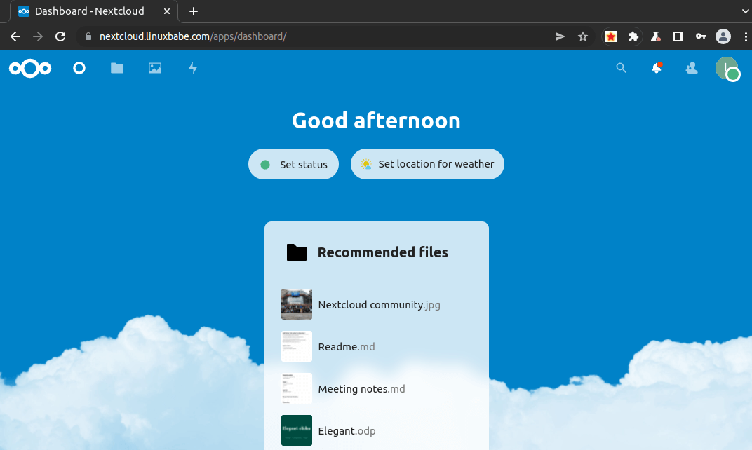

Is this a good tutorial?

For an install on a bare machine, it’s a good start. It does the basic install of webserver, php and database.
For a better performance, the use of caching is important, a few starting points to check are in the documentation:
https://docs.nextcloud.com/server/stable/admin_manual/installation/server_tuning.html
Especially redis was not mentioned, and the database caches (Database configuration — Nextcloud latest Administration Manual latest documentation).
