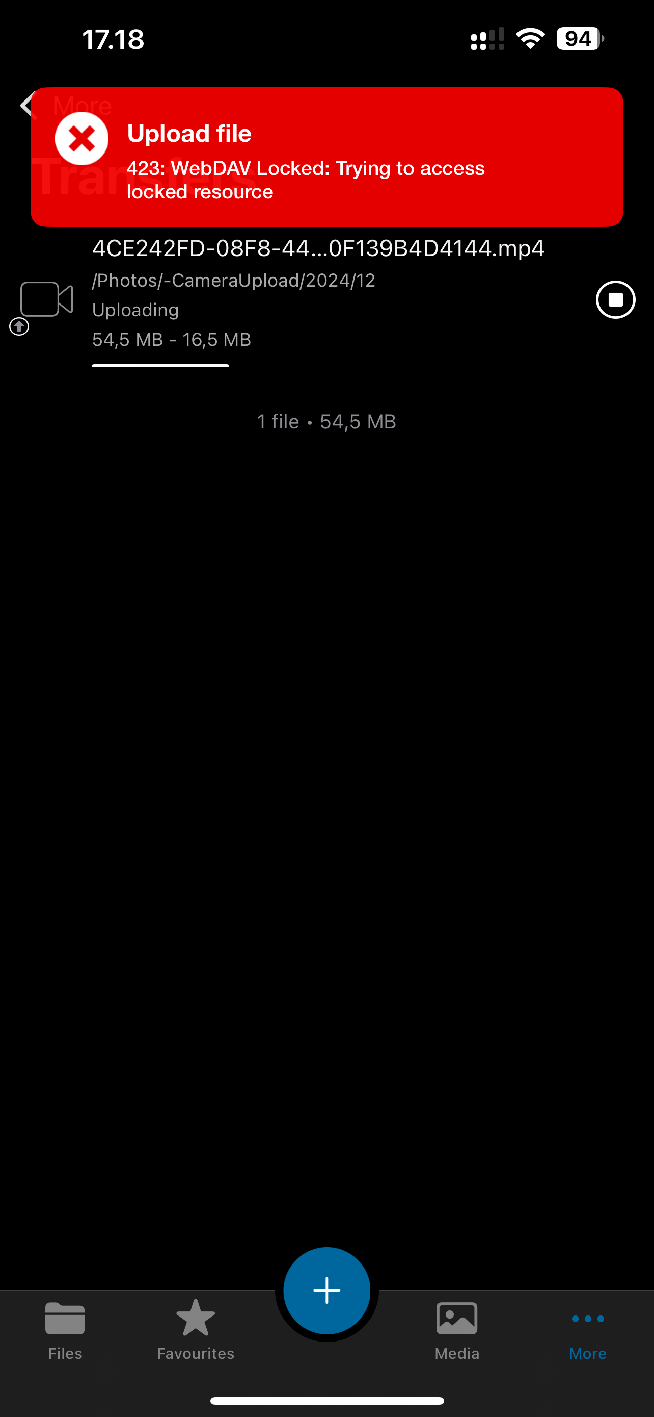

iOS NextCloud App 1 specific mp4 file constant reinitiates upload
Hi
I have a fully updated 1 month old NextCloud installation.
In my iOS app I have enabled that NextCloud should upload all my photos and it is also working for almost all files but 1.
When I look in the “Transfers” list in the iOS app it looks like the upload restarts after 1-3 seconds.
the file is only 54,5 MB large and 1GB+ files have been uploaded without issues.
See: https://streamable.com/t2veyb
NextCloud gives the following error:

If more information is needed please request and I will provide as soon as possible.

Not sure if it is related, but I just switched to the NextCloud app and saw the folowing error:

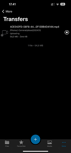

Close the app (stop it) … wait 30 seconds and open it again and the transfers view.
I haven’t figured out how, if it is possible, to search for filname. But will do some snooping, can’t have that many videos from tis month :sweat_smile:
After reopen just inactively sits like this
Should I try a force start again?
