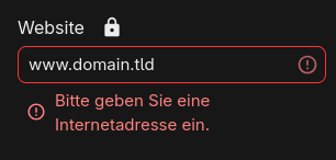

Invalid information is stored and cannot be deleted
Which version of Nextcloud are you using? When I tested it on a 31.0.8 instance, it complained when I entered an address without a scheme.
Unfortunately, I have discovered another issue after testing this: it does not seem possible to delete the contents of the field again. If I try to delete it, an error message appears stating that the value is invalid and the empty field will not be saved.
Yes, that is because the validate function is too restrictive:

@bb77: If you want to remove the Website data from your personal settings, you should remove it from the database with this query (replace $user_id):
MySQL:
UPDATE oc_accounts SET data = JSON_SET(data, '$.website.value', '') WHERE uid = '$user_id';
(PostgreSQL is different)
and then run
occ dav:sync-system-addressbook
After that the “Website” field is empty again.

However, I would also consider it a bug because deleting an entry should definitely be possible from the web UI.
