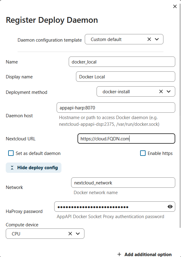

I am interested in installing ExApps and I have been following the documentation from Nextcloud as well as the documenation on GitHub. I have a working docker container for appapi-harp that is bound to 127.0.0.1:8070. They can also communicate over a docker network (nextcloud_network). When I try to add harp API to my nextcloud daemons, I get an error. When checking the logs it mentions that it cannot curl appapi-harp:8070/v1.41/_ping. My understanding is that harp is meant to serve this page, but instead I get a 404 error. When I look into the docker container logs, it is actually getting the request but says Invalid request path.
I am a bit of a newbie here and just trying to dive in the deep end. With that caveat, my understanding is that nextcloud expects the harp container to serve /v1.41/_ping but the harp container isn’t ready for it. Is there something I am missing here? I have looked around the internet and not really seen anything on this, and I am also not reallly sure what I could have misconfigured if the harp container isn’t serving a page it should be serving.

So I looked to the admin console.
 ConnectException cURL error 7: Failed to connect to appapi-harp port 8070 after 0 ms: Couldn't connect to server (see https://curl.haxx.se/libcurl/c/libcurl-errors.html) for http://appapi-harp:8070/v1.41/_ping

To my knowledge you’d need to be running v32 (i.e. a development stack):
@jtr
Thank you :smiley:. I should have dug deeper on GitHub. Now I need to decide if playing with this is worth setting up a development stack…
