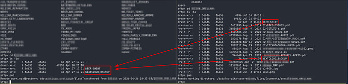

  • I initiated an ownership transfer of a very large directory from one user to another.
  • It seems that it never finished because I never got a notification that the transfer was complete
  • Some of the directory structure seems to have copied over, but there are still files in the original location
  • The new location has mostly empty directories everywhere, but there does exist some real data.
What can I do in this situation where files seemed to have never completed their transfer, but seemed to have initiated the ownership transfer?
The list on the right exist in the account I was transferring from, and the left is where I was transferring to. It seems that only the directory structure copied over.
