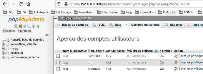

I have checked my phpadmin (see image below) with my credential
But I have always this error

I followed your advice and create a user for phpadmin “ncdb” (for nextcloud database)
image below
but I have the same error.
I have rechecked the user and noticed that my “ncdb” user avec not the localhost in field .
I did the correction without success (see image below)
I understand that not using root as user name is for a security reasion.
but as the login root with password allowed me to log on phpAdmin Webpage, that means this user exists and password is correct. Why nextcloud told me the MySQL username and password is not valid.
