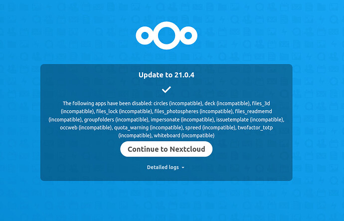

The only strange thing remaining was this message at the end of the update
I don’t know why it’s saying this since most of those app seem to be enabled, compatible and running when I go check in “apps”.
I almost felt that I was going to have to use my backups and re install everything but after an hour or so I was able to get this working so I hope my review about this can help someone that might have the same struggles. And if you understand why the apps were marked as incompatible but were in fact running, let me know!
