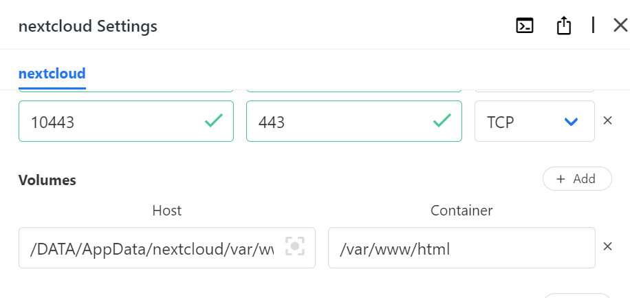

I do not use CasaOS. But maybe you must use for Host and Container the subdir data where the Nextcloud data and .ocdata is stored. Add /data.
Yes I use casa os for hosting and container for docker. All installations went smoothly and there were already /data and .ocdata folders in the file, I had used docker php but after I ran it using the CLI, what happened was that the program never stopped running then I pressed ctrl + c to end the command.

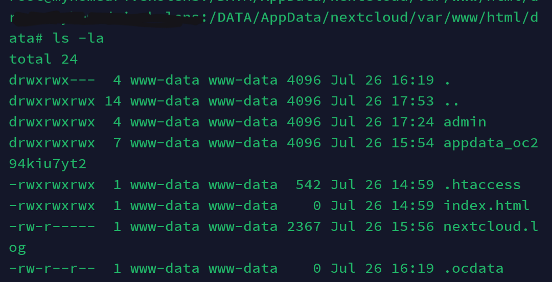

But when i use www-data this happend
root@jsjjsiwbaj:/DATA/AppData/nextcloud/var/www/html# sudo -u www-data php cron.php
{"reqId":"dJ71Nslt4iNAJgXfZpxO","level":3,"time":"2024-07-26T12:52:39+00:00","remoteAddr":"","user":"--","app":"PHP","method":"","url":"--","message":"fopen(/var/www/html/data/data_dir_writability_test_66a39c17994c8.tmp): Failed to open stream: Permission denied at /DATA/AppData/nextcloud/var/www/html/lib/private/legacy/OC_Util.php#572","userAgent":"--","version":"29.0.4.1","data":{"app":"PHP"}}
Your data directory is invalid.
Ensure there is a file called ".ocdata" in the root
of the data directory.
Your data directory is not writable.
Permissions can usually be fixed by giving the web server write access to the root directory. See https://docs.nextcloud.com/server/29/go.php?to=admin-dir_permissions.
{"reqId":"dJ71Nslt4iNAJgXfZpxO","level":3,"time":"2024-07-26T12:52:39+00:00","remoteAddr":"","user":"--","app":"PHP","method":"","url":"--","message":"fopen(/var/www/html/data/nextcloud.log): Failed to open stream: Permission denied at /DATA/AppData/nextcloud/var/www/html/lib/private/Log/File.php#82","userAgent":"--","version":"29.0.4.1","data":{"app":"PHP"}}
