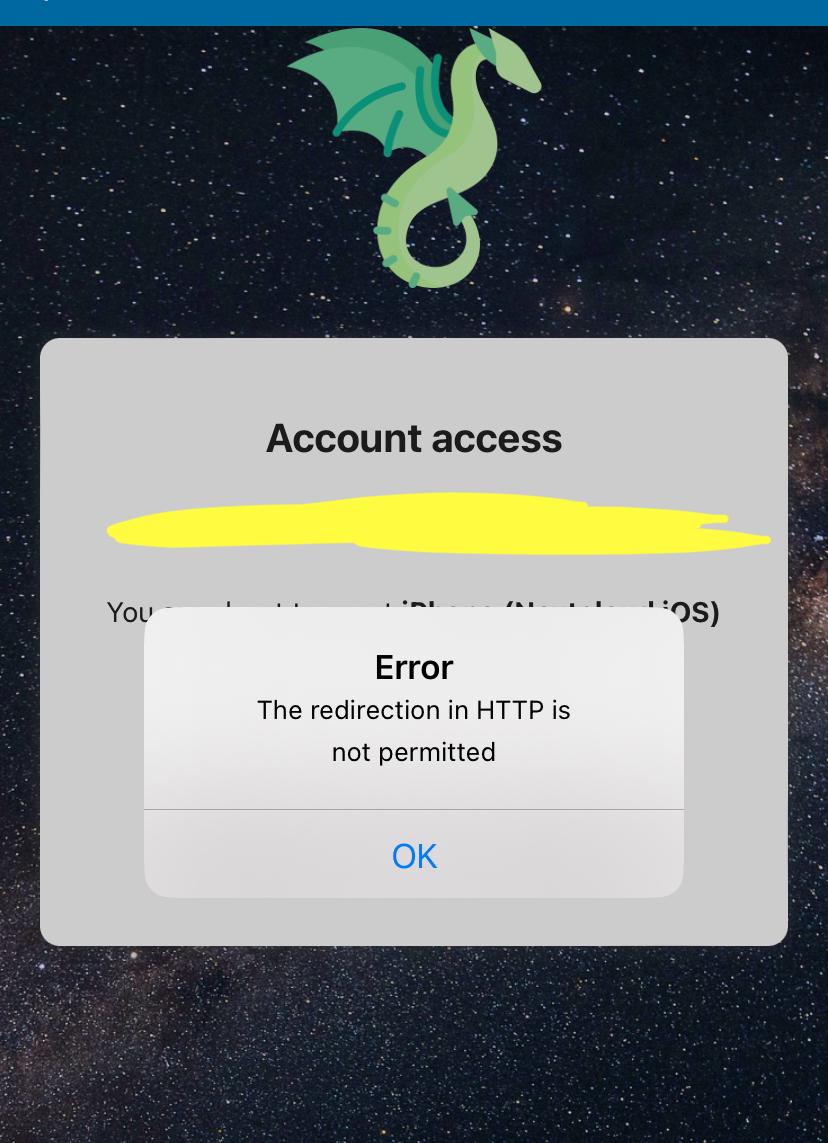

May i know how you have done this. In my usecase, i cannot use port forward as I live in a student accomodation. I am unable to access the nextcloud instance on mobile apps as it gives the error “the redirection in http is not permitted”. I was thinking to try this to see if this could help.
