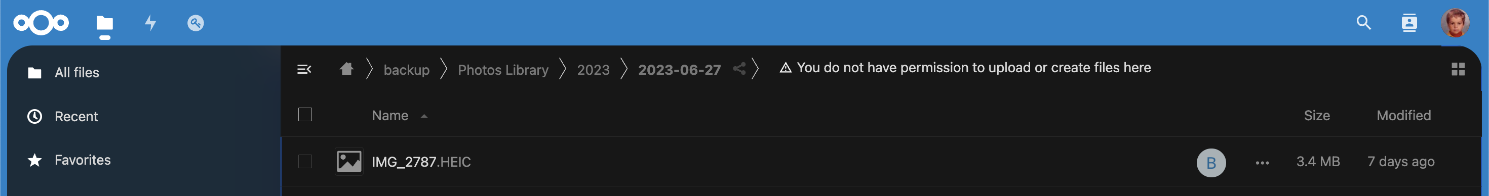

How to suppress "You do not have permission to upload or create files here" message?
I have a shared folder in my nextcloud containing a massive library of family photos, which I maintain externally using lightroom. I don’t want any users including me to be able to upload, delete or change the files here via nextcloud at all. So I have created a group with read only access to the folder and added the users to that group who should have read only access.
This approach is working quite well, except for the long message which displays persistently across the top - see screenshot below. On desktop it is only confusing, but on mobile it takes up space and is quite ugly.

It is part of the (shiped, always enabled) “files” App.
It is in the file
apps/files/templates/list.php in line 8
and in all the subsequent l10n files.

On mobile devices you should use the android/ios client instead of a browser. In the mobile client, that message is not shown.
I can take away your worry about problems with update. They cannot arise from this. At least not the way I implement them in my script. With the argument " -r " all made changes will be made undone and you will get your “vanilla nextcloud” back.
Of course you can make a PR but I do not find that message awkward. I find the message is OK and I think that you will not find much suport for that PR. In particular because your argument with the mobile is actually none, because there is a separate solution.
It is much easier to run a little script and change two lines of code for your personal use case and demand instead of changing the code for millions of users who got accustomed to it, like the tail wagging the dog. :wink:
