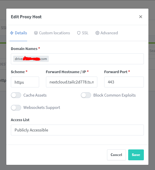

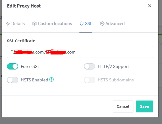

okey thanks, I installed nextcloud aio to work with tailscale, so when i enter from tailscale domain works perfectly but on the vps when I try to redirect with nginx proxy manager it returns “502 Bad Gateway”. So I’m trying to fix that.
Bad gateway indicates that something is going wrong in the step where you are trying to forward the connection from the proxy to the server hosting the instance.
Maybe you can share your configuration and how things are sat up, and I can help you take a look if you still need help?
yes, this is my configuration in nginx
if i put in shceme http, page load but return “Client sent an HTTP request to an HTTPS server.”
or if i use caddy
drive.domain.com {
    reverse_proxy https://nextcloud.tailc2d778.ts.net
the page goes blank
Since your tailscale network is already behind closed doors, you do not need to worry that someone is doing “man in the middle” attacks, or snoops on the trafffic. Your requirements may be different, but to the looks of it, I do not see why you need to use SSL between nextcloud and the front facing server :slight_smile:
That will allow you to send a http (not https) connection to the backend.
I recommend looking at what you have set APACHE_PORT to, and that you are pointing your reverse proxy to that port :slight_smile: (Do not point it to 443, that requires a valid cert…)

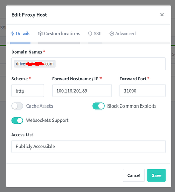

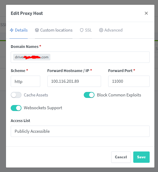

Thanks for your help! I was able to resolve it recently.
I had previously used this guide (the one you mentioned) to set it up with Tailscale, but I had to make these modifications to make it work.
Here are the steps I followed:
Home Server:
  • Change APACHE_IP_BINDING to 0.0.0.0
  • Modify Caddyfile (not sure if this is necessary), replacing LOCAL_SERVER_IP with the private IP (in my case, 192.168.0.5)
    layer4 {
        127.0.0.1:3478 {
            route {
                proxy {
                    upstream LOCAL_SERVER_IP:3478
        127.0.0.1:3479 {
            route {
                proxy {
                    upstream LOCAL_SERVER_IP:3479
https://{$NC_DOMAIN} {
    reverse_proxy LOCAL_SERVER_IP:11000
http://{$NC_DOMAIN} {
  • Configure Nextcloud with my domain and NOT with Tailscale’s domain.
VPS:
  • Insert the home server’s IP provided by Tailscale with port 11000 (in my case/default).
  • If you want to use Talk, enable Websockets Support.
Example:

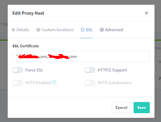

  • Add SSL to use HTTPS (to avoid issues).
  • Disable Force SSL (Having it enabled at first didn’t cause me any problems, but later, it caused an infinite loop of redirects.)
Example:
This is it! I hope this helps someone so they don’t struggle like I did haha. Thanks for the help!
