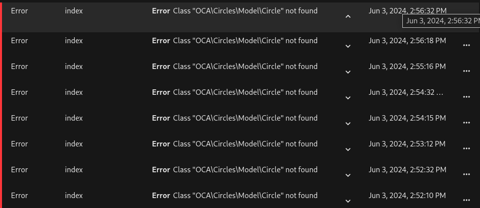

The problem is that before I found the hint about disabling the circles app, I could not see any log entries. Like in the issue above, I saw: “More details can be found in the server log.”. But where i the server log? I have tried:

Now that I can login and the UI is working again I can see/find:
But how do I perform this when using Nextcloud AIO with/without the UI working?

Hi, see https://github.com/nextcloud/all-in-one/discussions/4745#discussioncomment-9645538
Ok, so the log file is stored in data/nextcloud.log in the nextcloud_aio_nextcloud volume. That was non-obvious…
