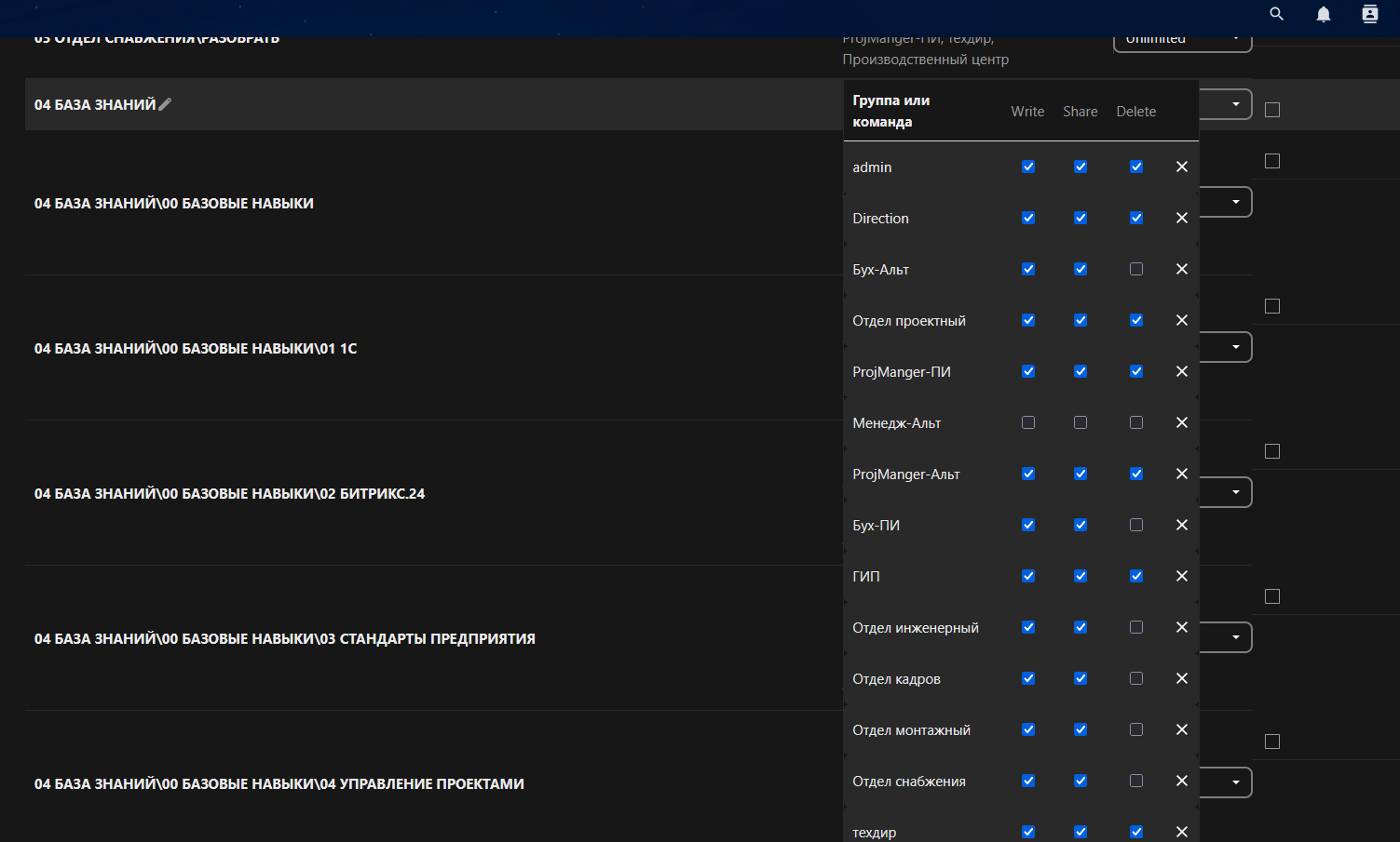

The only solution I’ve been able to make is to use group folders for the main structure. if you accidentally move it, it is copied, but not deleted.
It should be noted that if a user is granted access to a folder of level 2 and above, without access to the first level, then the 1st level is displayed as a personal folder, and there have been cases when users have saved files there.

In case of groupfolders, your users will not be able to change the top-level folders of group folders - they will be just subscribed to them with appropriate roles (write/share/delete/admin), see over here https://github.com/nextcloud/groupfolders.
In case of shared folders, make the top-level folders read-only, and ALL the 2nd level folders writable (if needed). So, the users will not be able to create own folders and files in the 2nd level, but in the 3rd level.
