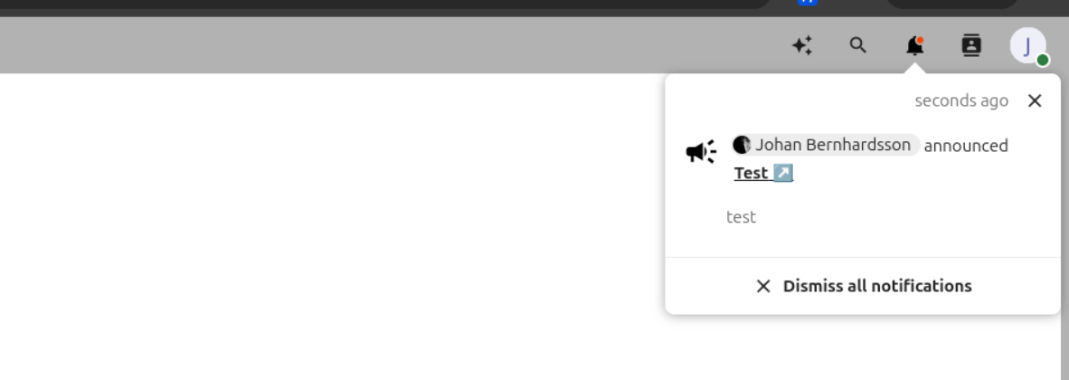

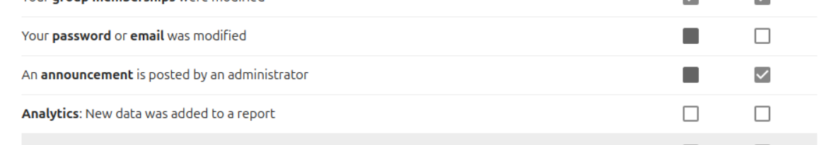

If you sepcify as an admin that notfications should be sent as push messages they should show up from announcement center under the bell icon.
@SmallOne How to specify that and send on behalf of admin? Eg, I am an admin, I created the message in applicationcenter, and I do not see that message under the bell icon.
@Kerasit Can I ask you to adjust the code in order I can read the text from a file and place it in the notification, ideally formatted with paragraphs?
So the user must have push notifcations on, default is to only send email.
