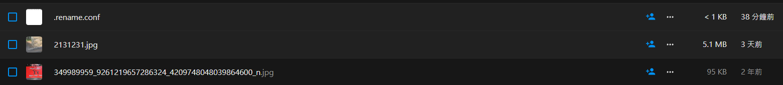

attached is file name list.

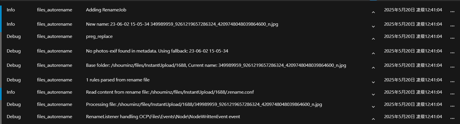

After update to 2.1.1,
i got the info as below for two pic.
first one,
second,

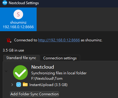

1.Does this app need to be run with administrator privileges? Because I uploaded the image through the user account, but checked the log in Admin account in WebUI.
2.My computer is Windows 11, I put the images into a Windows folder that is synced with nextcloud internally.

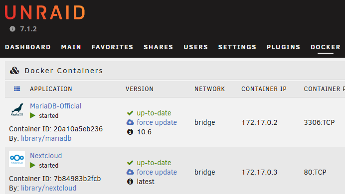

3.My Nextcould run in UNRAID’s docker mode.
The screenshots of the logs you shared always show the “Adding RenameJob” message, but not the start of the background job where the actual renaming happens. In the logs, there should be something like “RenameJob running”.

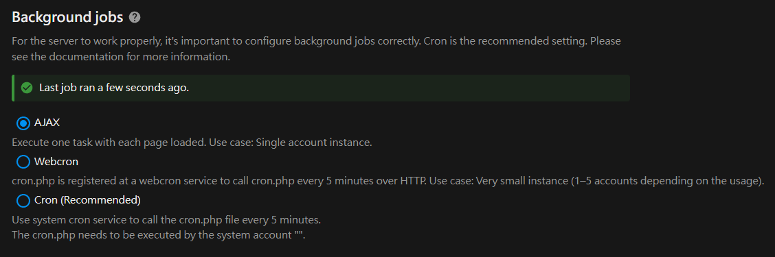

You’ve configured background jobs to run with the AJAX option. This method is rather unreliable and not recommended. I tested it myself—it took about 4 minutes of continuously refreshing the page before the AutoRename background job started and the file was finally renamed.
I recommend using cron for background jobs instead. I’m not familiar with Unraid specifically, but I found this post that might help setting it up using the “User Scripts” plugin: https://forums.unraid.net/topic/88504-support-knex666-nextcloud/#comment-822737
