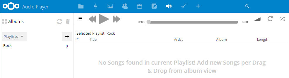

Unfortunately I faced a problem: how to add the song in the playlist?

I successfully added files and they are visible in genres, albums, years and so on. But if I select “Playlist”, then nothing is displayed. My question: how to add files in the existing playlist?
Here:

This is how it worked for me:
  1. go to audio-player
  2. in the dropdown menu on the top left click on Playlists
  3. with the “+” just to the right of the dropdown menu you can create and name a new playlist.
  4. in the main content area is now something about “drag and drop add blah”. But how? Where? What?
  5. above your playlist on the left there is something like “last added”, “last played” etc…
    Open one of these lists so that the desired tracks are displayed on the main content page.
  6. here simply drag and drop left in your playlists.
Hope I could help you :slight_smile:
