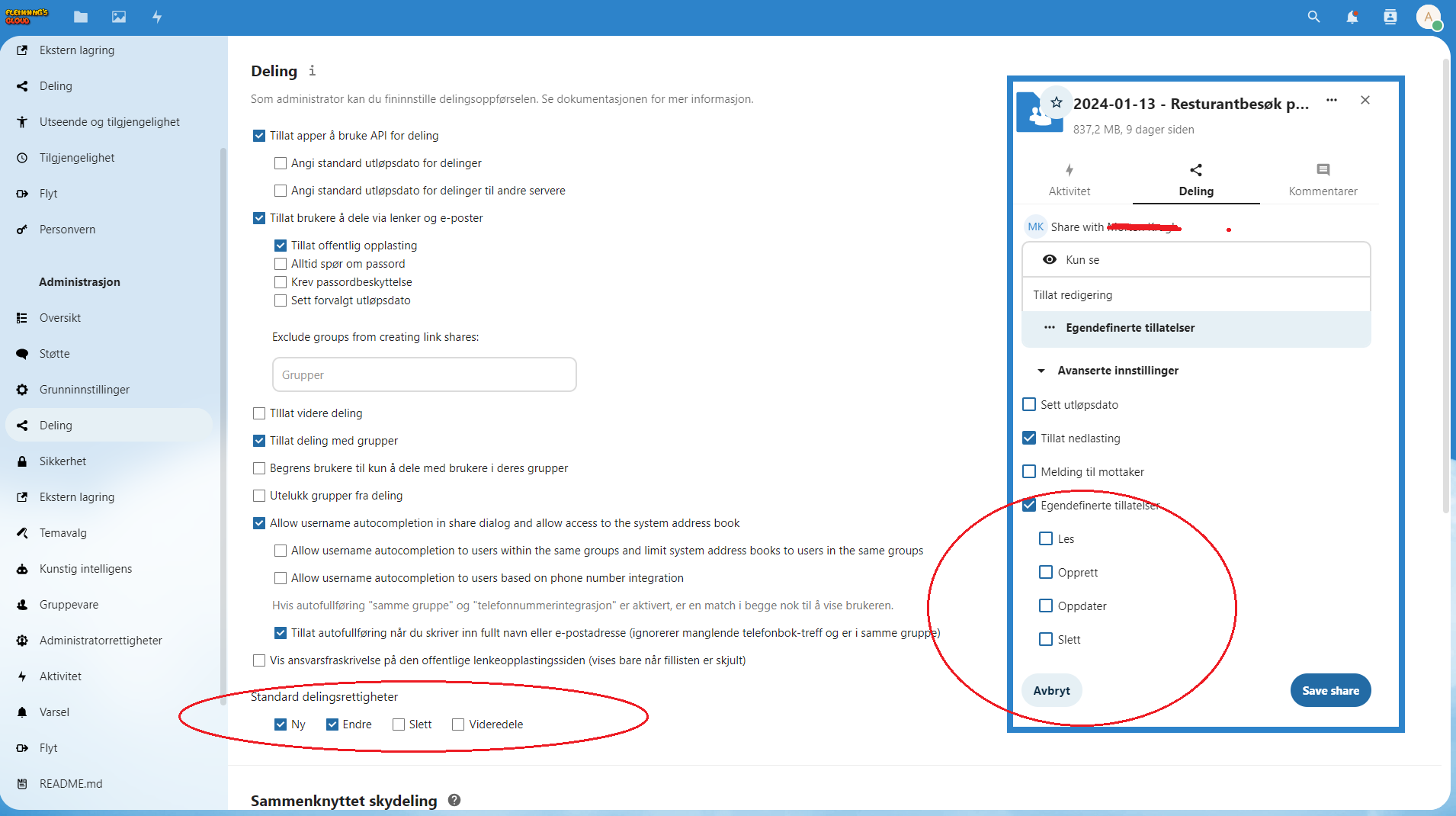

In earlier versions of NextCloud I had set default sharing permissions. (when sharing a folder, permissions like “Read, Write, Create” set by default.
I can’t find that in my more updated version 27.1.4 .
I have set default sharing rights in in settings/admin/sharing, but it looks like it is not applicable while sharing.
How do I set these defaults?

Hi @flemmingss ,
you migth check this bug for an answe:

The "Default share permissions" does not seem to be working.
Maybe I just don't understand what it is supposed to do.
I am not sure I understand the following line from [the documentation](https://docs.nextcloud.com/server/latest/admin_manual/configuration_files/file_sharing_configuration.html)
> With Default share permissions you are able to set the default permissions for user-shares (Create, Change, Delete and Reshare) without forcing them.
Does it mean that existing link permissions won't change, but new link will have the default permission set ? If yes, this is what I expect.
### Steps to reproduce
1. Go to Settings -> Administration Settings -> Sharing
2. Check all the check-boxes under "Default share permissions"
3. Go to the file explorer
4. Create a new link, and then open the link settings
### Expected behavior
I would expect that the new link is created with the default permission that are set in the Administration Settings

Maybe the the Configuration Parameters in config.php ?
Thanks, looks like the exact same issue
EDIT: Not the same, my applies to internal links also
