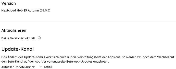

View also:
As you can see, there is for some reason also no Update offered from 32.0.6 to 33.0.0.
