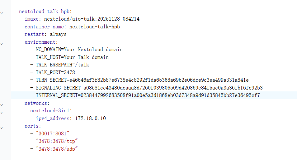

Okay, first, the compose parameters:
Use the high-performance backend image from aio,
  • NC_DOMAIN = Your Nextcloud domain
  • TALK_HOST = Your Talk domain
  • compose👇
  • nextcloud-talk-hpb:
    image: nextcloud/aio-talk:20251128_084214
    container_name: nextcloud-talk-hpb
    restart: always
    environment:
    • NC_DOMAIN=Your Nextcloud domain
    • TALK_HOST=Your Talk domain
    • TALK_BASEPATH=/talk
    • TALK_PORT=3478
    • TURN_SECRET=e46646af3f82b87e6738e4c8292f1da65368a69b2e06dce9c3ea499a331a841e
    • SIGNALING_SECRET=a08581cc43480dcaaa8d7260f039806509d420869e84f5ac0a3a36fbf6fc92b3
    • INTERNAL_SECRET=0238447992683508f91a00e5a3d1868eb03d7348a9d91d35845bb27e36495cf7
      networks:
      nextcloud-3in1:
      ipv4_address: 172.18.0.10
      ports:
    • “30017:8081”
    • “3478:3478/tcp”
    • “3478:3478/udp”

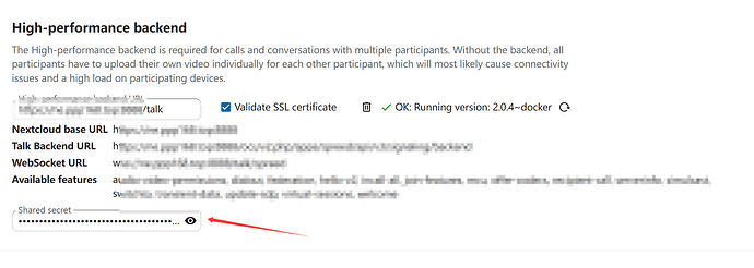

Enter the SIGNALING_SECRET parameter here

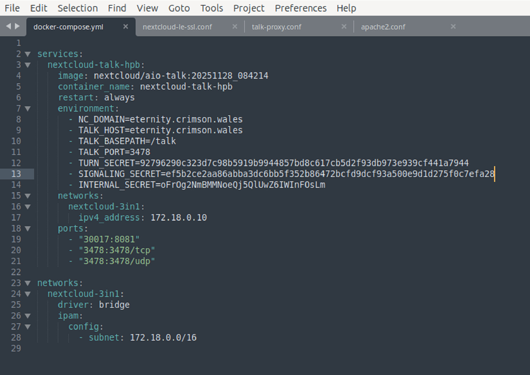

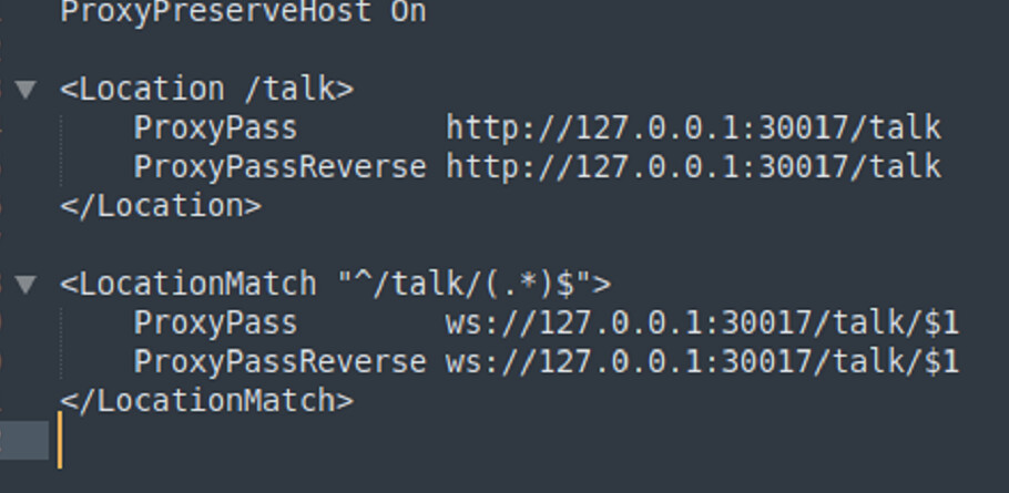

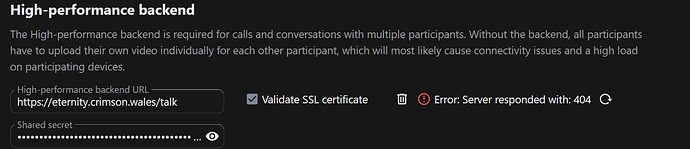

Many thanks for the info. Tried following as closely as I could this is the compose file
And the nextcloud conf file (I’m running apache)
Also added this conf file which should do the same as the proxt setup you’ve posted.
Yest still getting a 404 error in the talk settings.

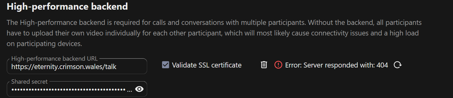

Any help would be most welcome as I seem to be going around in a loop trying to resolve where the issue is.

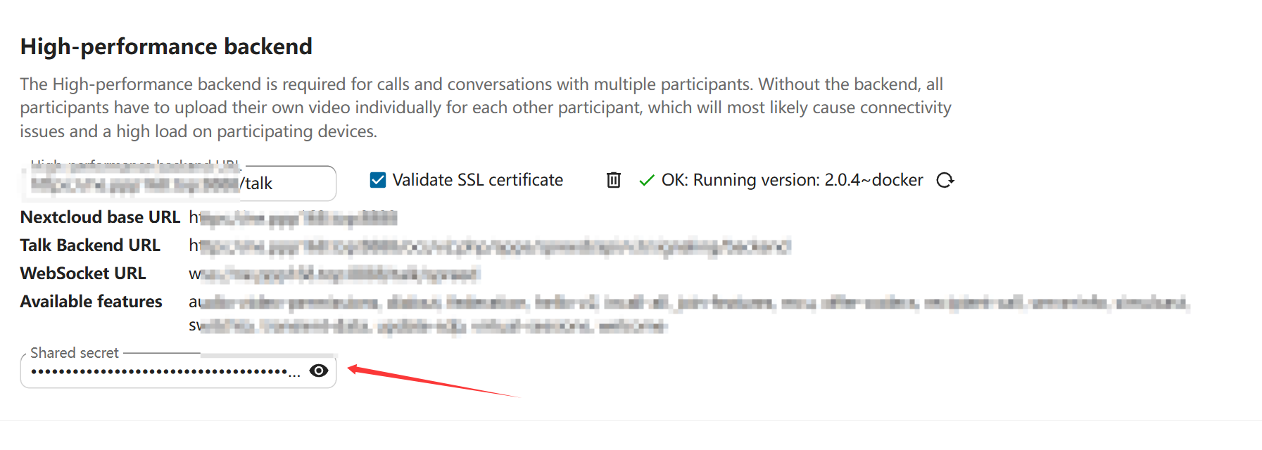

You did enable “Validate SSL certificate” in your last screenshot, but if I did understand you right, you do not have a SSL certificate.

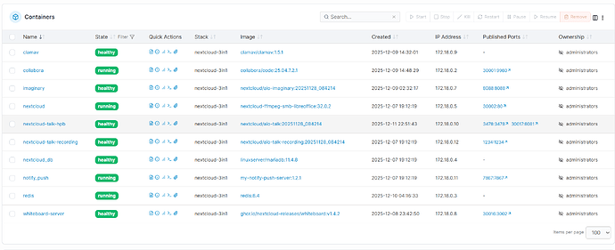

You don’t have to copy my configuration exactly. I defined a network called nextcloud-3in1, and the fixed IP address only exists within this network.You should put the high-performance backend and NextCloud on the same Docker network, instead of following my configuration for everything.

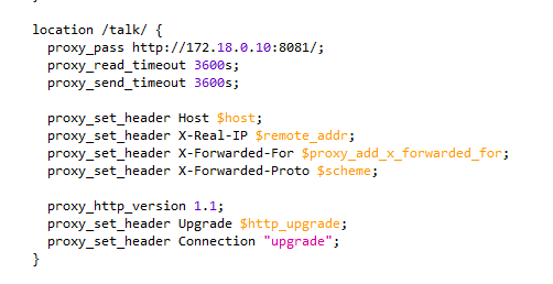

Because my nginx container is also on this network, my reverse proxy can be directly set using proxy_pass ``http://172.18.0.10:8081/. If it’s not on the same network, enter your host machine’s IP address and port, for example, http://192.168.1.201:30017/; where 192.168.1.201 is my host machine’s IP address.
Below are all the parameters for my reverse proxy. Please fill in your own domain name and port.:backhand_index_pointing_down:

    location /talk/ {
      proxy_pass http://172.18.0.10:8081/;
      proxy_read_timeout 3600s;
      proxy_send_timeout 3600s;
      proxy_set_header Host $host;
      proxy_set_header X-Real-IP $remote_addr;
      proxy_set_header X-Forwarded-Proto $scheme;
      proxy_http_version 1.1;
      proxy_set_header Connection "upgrade";

Ticked or unticked I get the same result.
