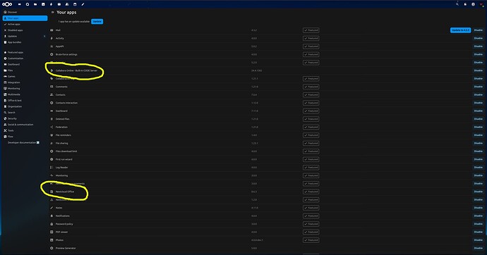

Ok. Go in Nextcloud GUI → “right top” → “Apps” → “Your apps” and install the apps Nextcloud Office and Collabora Online - Built-in CODE Server. After that look in your administration settings. Post e.g. screenshots or errors.

The apps you have listed are already installed. These are screenshots from both my desktop on the local net and my mobile device via the WAN.

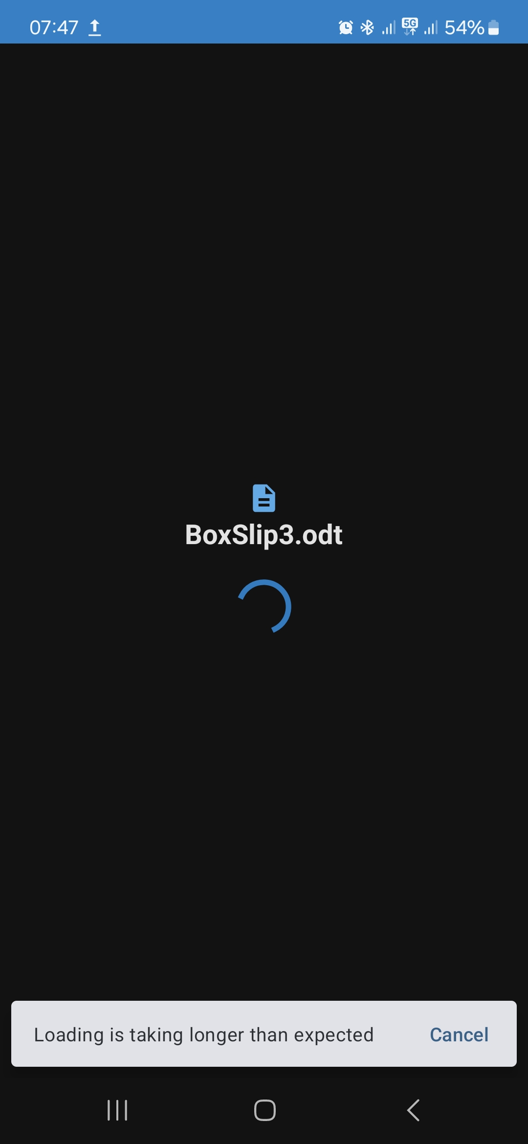

This is the screen on the mobile device when trying to connect:
The log file has a lot I’m not comfortable sharing openly (IP Addresses, usernames etc). That Said I cleared the log and attempted a connection. Here are some sections of log text that seem relevant:
"Failed to convert preview: cURL error 7: Failed to connect to A.B.C port 666 after 32 ms: Couldn't connect to server (see https://curl.haxx.se/libcurl/c/libcurl-errors.html) for https://A.B.C:666/apps/richdocumentscode/proxy.php?req=/cool/convert-to/png"
"Could not decrypt or decode encrypted session data"
"Failed to convert preview: cURL error 7: Failed to connect to A.B.C port 666 after 0 ms: Couldn't connect to server (see https://curl.haxx.se/libcurl/c/libcurl-errors.html) for https://A.B.C:666/apps/richdocumentscode/proxy.php?req=/cool/convert-to/png"
"Call to a member function xpath() on false in file '/var/www/nextcloud/apps/richdocuments/lib/WOPI/Parser.php' line 41"
Server address mangled to A.B.C, and my chosen port isn’t 666. The client uses these addresses for file sync fine.
