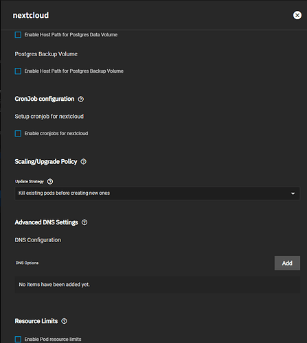

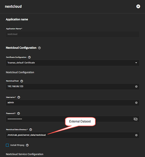

The configuration I’m using is as follows:

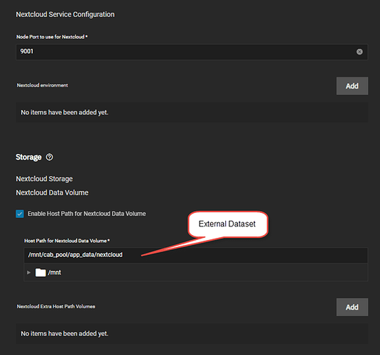

I have chosen an external dataset for the user files (which I will also expose via SMB) with the following permissions:
Host path location is:
The Host Path / application configuration files location is suggested by Tom Lawrence in his talk: https://youtu.be/vXGs221il3g
Having the following permissions:
Rest of Config:
