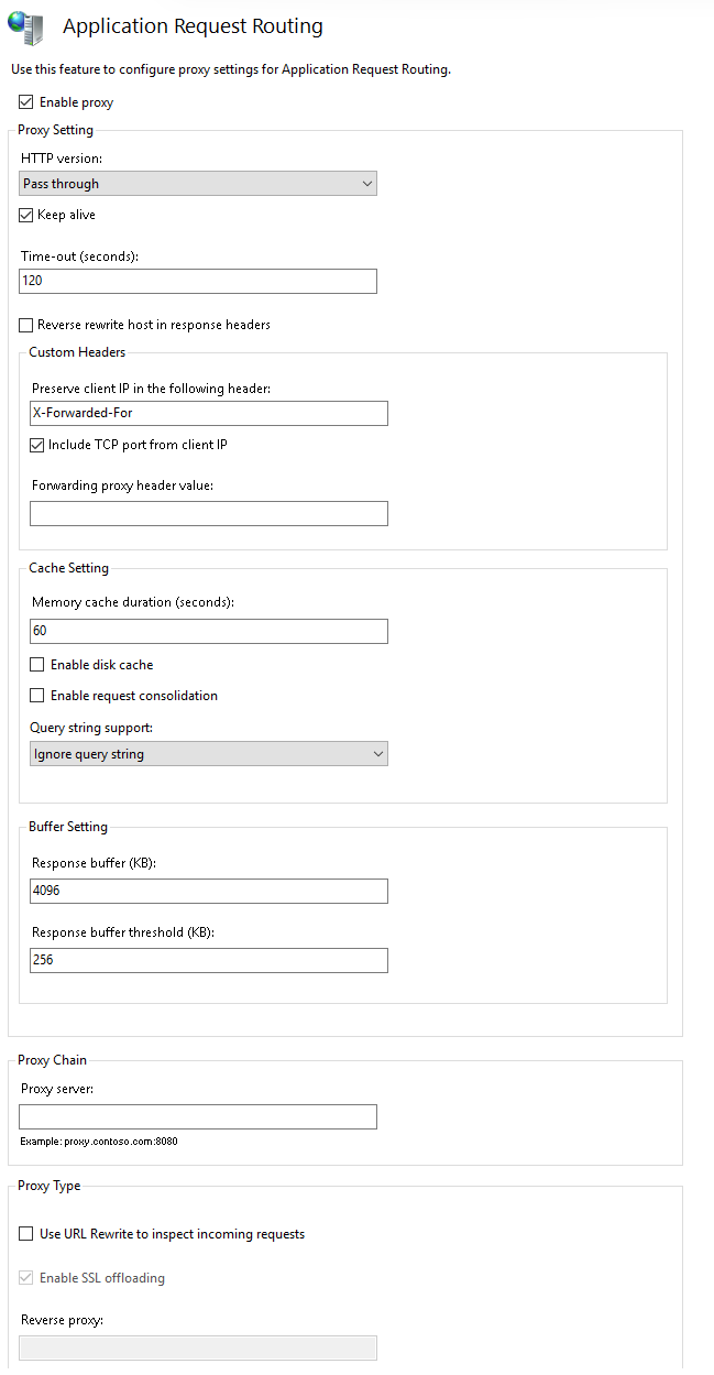

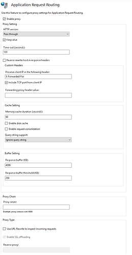

Set up ARRM
Configure ARRM as follows:

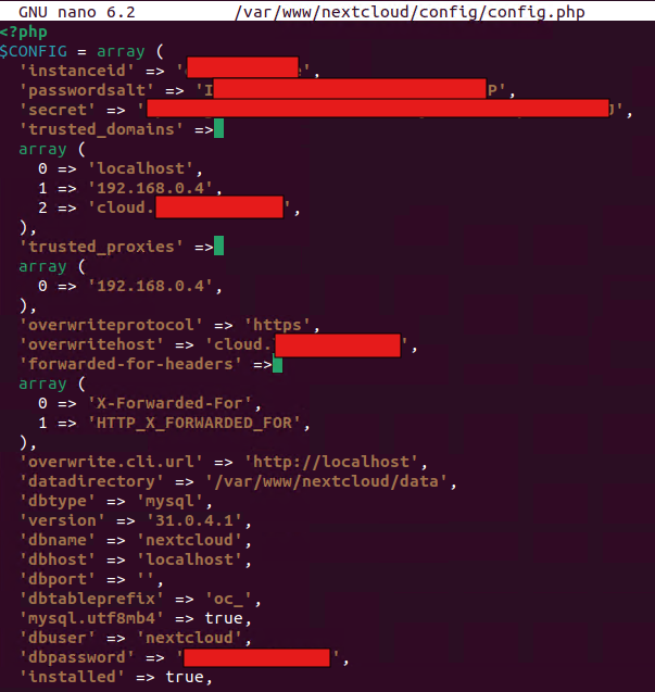

Nextcloud config file
Your config file should look like this:
