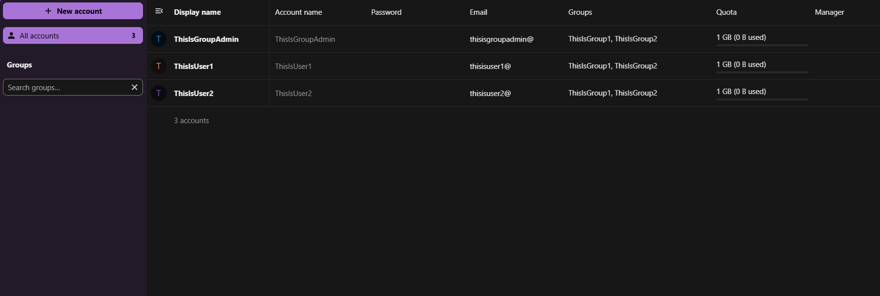

Group administrators in Nextcloud are unable to create users within the groups they administer. Instead, they are only shown the admin group, which they are not admins of, preventing them from managing the members of their assigned groups.
  1. Access Nextcloud with an account (ex. ThisIsTestAdmin)
  2. Go to the Accounts page (https://cloud.example.com/settings/users)
  3. First hint that something’s wrong is that I can’t see the groups I’m part of nor group admin of.
    Current behavior:
    Expected behavior (Paint edit):
  4. Press the + New Account button.
  5. Try to assign a group in the “Member of the following groups” sections.
  6. You’ll only be able to select the “admin” group, even if the group admin is not an admin.
    Current behavior:
