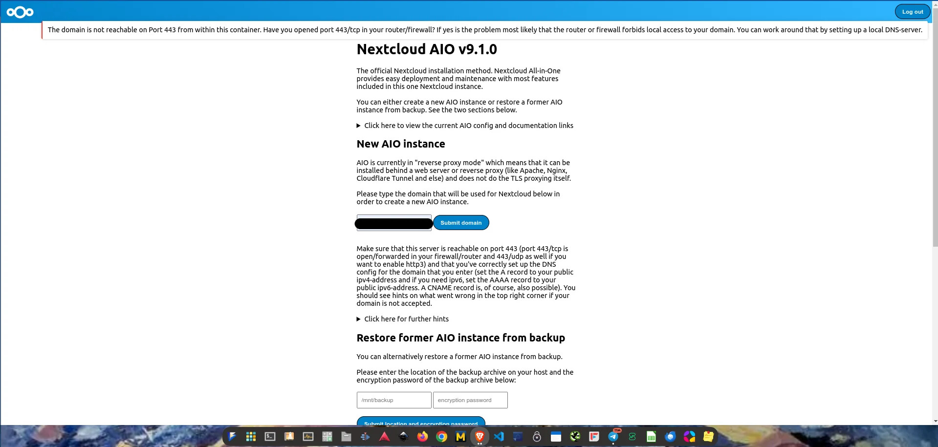

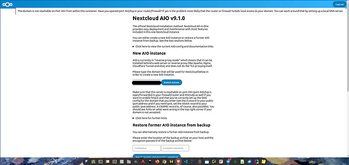

Was struggling to get it running following the official GitHub documentation, behind Nginx Proxy Manager. Was able to access AIO installation screen, but when putting my subdomain, I kept getting this error: “The domain is not reachable on Port 443 from within this container. Have you opened port 443/tcp in your router/firewall? If yes is the problem, most likely that the router or firewall forbids local access to your domain. You can work around that by setting up a local DNS-server.”
I tried Caddy instead, also tried running Pihole container to try the local DNS suggestion. Both containers were up and green, my 443 port on router is open, ports 443 and 80 are mapped to my server, and A record set to the public IP of the router. Still got the same error on AIO. But now, by following a youtube video, I was able to get it running locally on the local IP I set through the macvlan setup.
