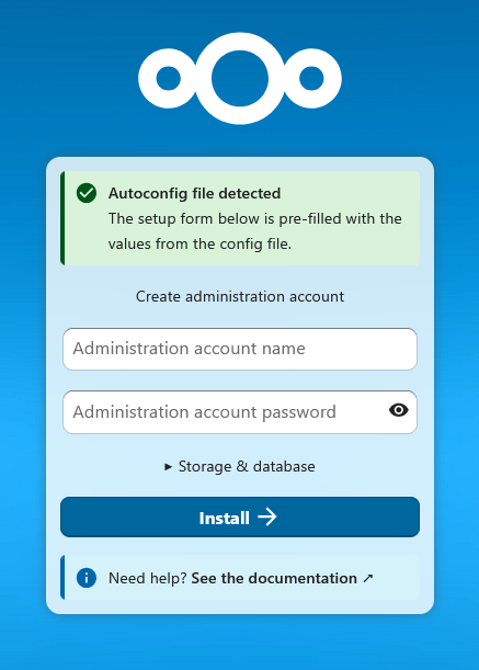

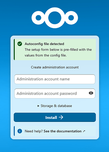

I have no idea what happened, but it fixed itself lol. Maybe all I need is to wait and restart a few times. I can see the initialization page now. Thank you all for the information. I’ll check my setup.
