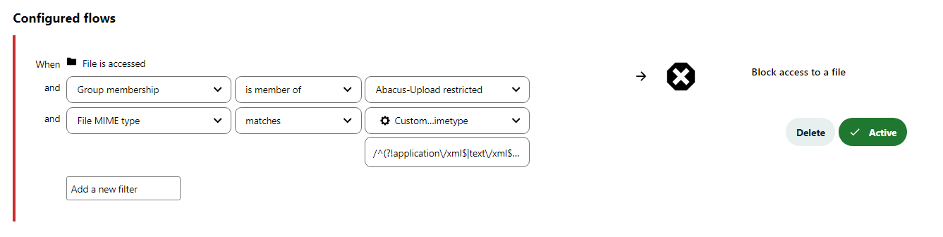

I would like to set up file access control.
The goal is that only members of a “restricted” group can upload xml and txt files. Other file types are not allowed.
Steps to replicate it:
Install the App "Files access control
Fill out
Configured like this I can upload everything except xml files.

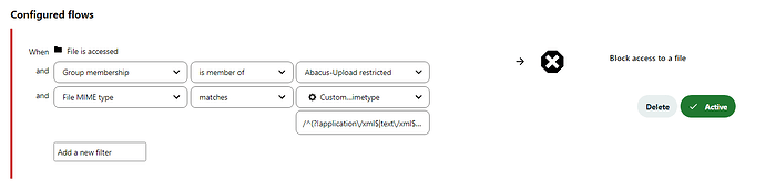

If I now change “matches” to “does not match” only the upload of xml files should work according to my understanding. But then I can’t upload anything at all.
What is perhaps also important: The files are uploaded via WebDav.
