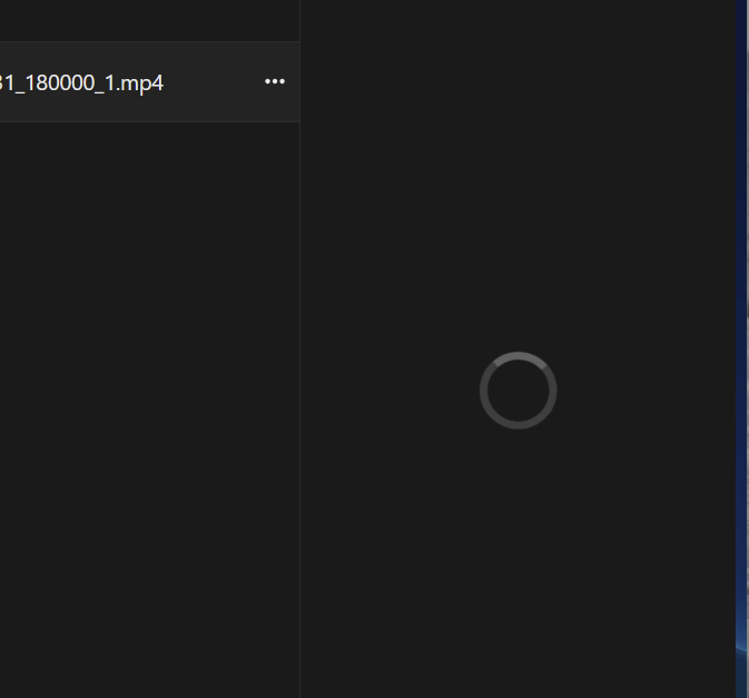

File Details not showing up on sidebar
Nextcloud version _(eg, 29.0.5): 30.0.1
Operating system and version (eg, Ubuntu 24.04): Unix-Based (Unraid)
Apache or nginx version (eg, Apache 2.4.25): NGINX
The issue you are facing:
Anytime I try to load file details in nextcloud (under my admin account), the sidebar doesn’t actually populate and just has a spinning wheel. My logs don’t show any errors or issues with this and no errors are populated. I’ve tried restarting Nextcloud docker to no avail. I noticed this when I tried sharing (sharing is enabled) however, the issue is not necessarily linked to sharing as it occurs when I just click the file to view File Details.

There were no errors in the logs however, I was about to fix the issue.
I used the CRTL + SHIFT + R (refresh cache) and it worked without issue afterwards. Bizarre but at least it works.
