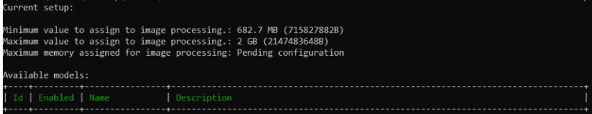

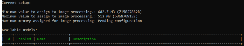

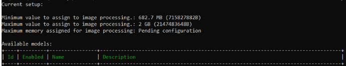

The child container wasn’t picking up the new php memory limit (checking with php occ face:setup).

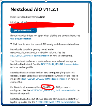

I tried deleting nextcloud_aio_mastercontainer and from localhost:8080/containers remade initialization (it gave me a new passphrase).

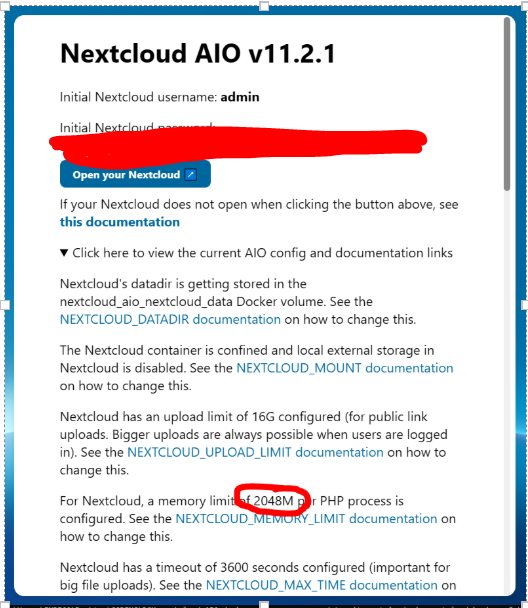

Now it shows an updated memory limit
BEFORE
AFTER

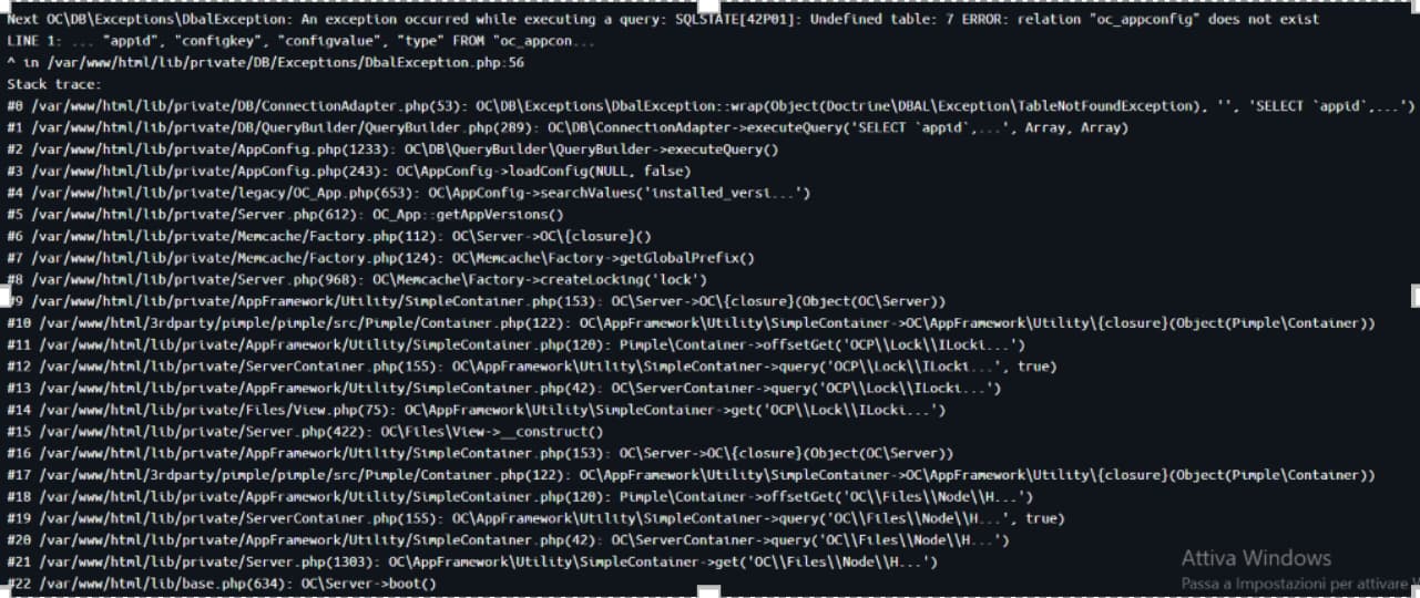

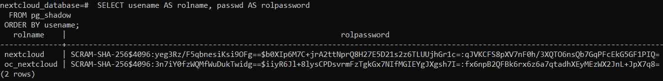

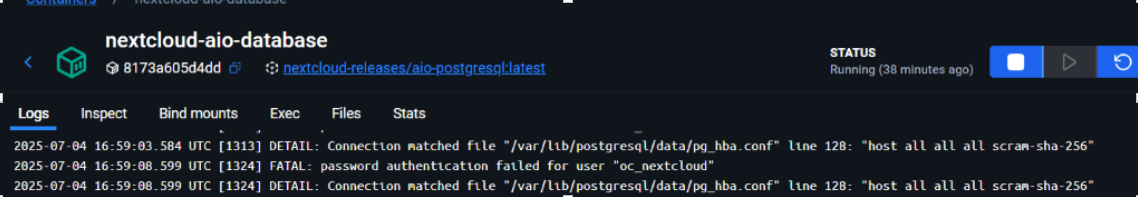

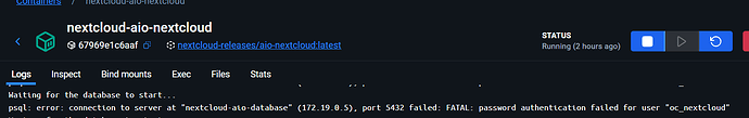

I can clearly see from logs that Database is the blocking point cause Nextcloud has FATAL error trying to connect with oc_nextcloud user at db.
I see in config.php the dbpassword plaintext and also logged in database and tried to launch ALTER USER oc_nextcloud with PASSWORD dbpassword.
And the hash changed after (checking table pg_authid and pg_shadow on the db).
But I still get the same error. Seems like it is only a last stupid account sync issue but I run out of ideas on how to fix it.

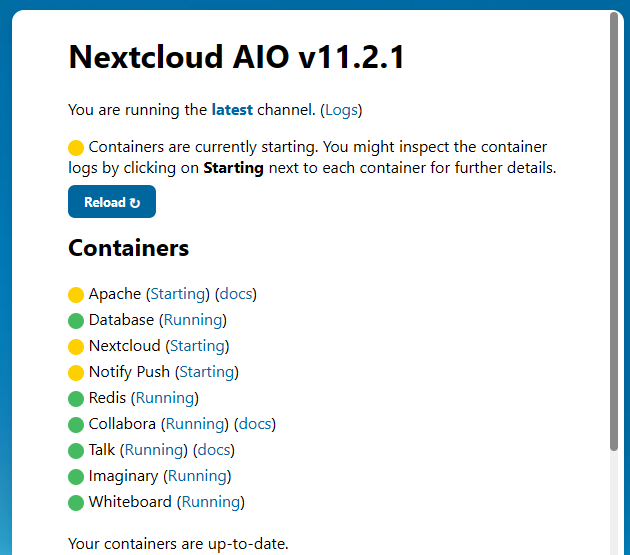

  5. docker stop nextcloud-aio-apache (to be able to login to localhost:8080 cause blocked when reverse proxying and in the meantime nextcloud.MYTAILSCALE.ts.net/settings/admin was also unreachable)

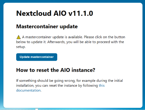

  6. localhost:8080/containers It sees a changed mastercontainer configuration and ask to update
PASTE HERE
Failed to load resource: the server responded with a status of 502 ()
ON CONTAINER NEXTCLOUD-AIO-APACHE in Logs I see inifinte:
Waiting for Nextcloud to start...

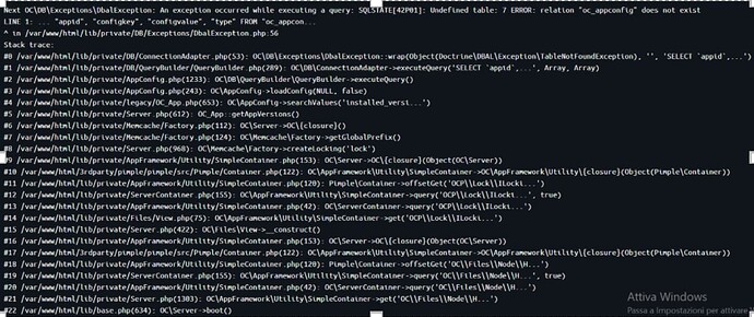

  1. Tried deleting DB container e volumes → n-aio-apache gave strange DB tables errors (If I remember well)

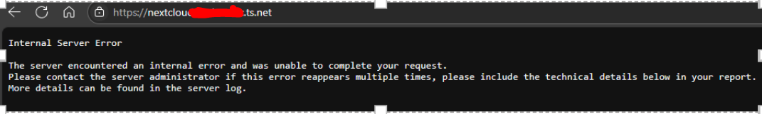

  2. Tried deleting also Apache container e volumes → n-aio-nextcloud gave (different) strange DB tables errors + webpage gave Apache internal server error
  3. Tried deleting all containers&volumes except Nextcloud_data volume → n-aio-nextcloud gave strange (maybe) user profiles errors (it seems like It was cause in the volume there was already an Admin profile) + webpage gave Apache internal server error
