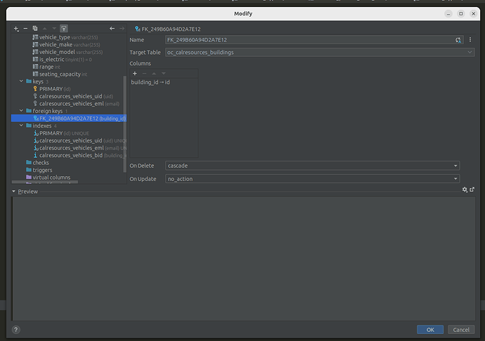

While foreign key constraints are not often used in our codebase, they should still work if we expose that functionality. The addForeignKeyConstraint something provided by doctrine/dbal. I don’t see why it should not work.
The following migration is using addForeignKeyConstraint and the relations are created properly on my dev setup.
