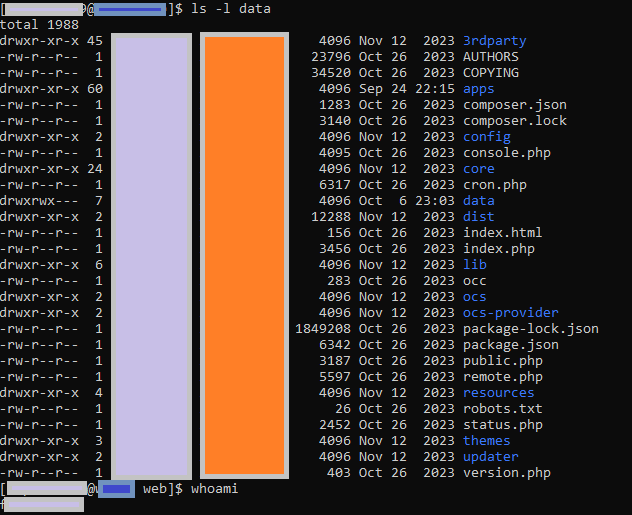

What is the output of
whoami
and
ls -l /path/to/nextcloud/
ernolf
So this is the outcome:
All Users beneath the violet block, are structured as
ftpUSERID
, everything hidden by the orange block is
siteUSERID
