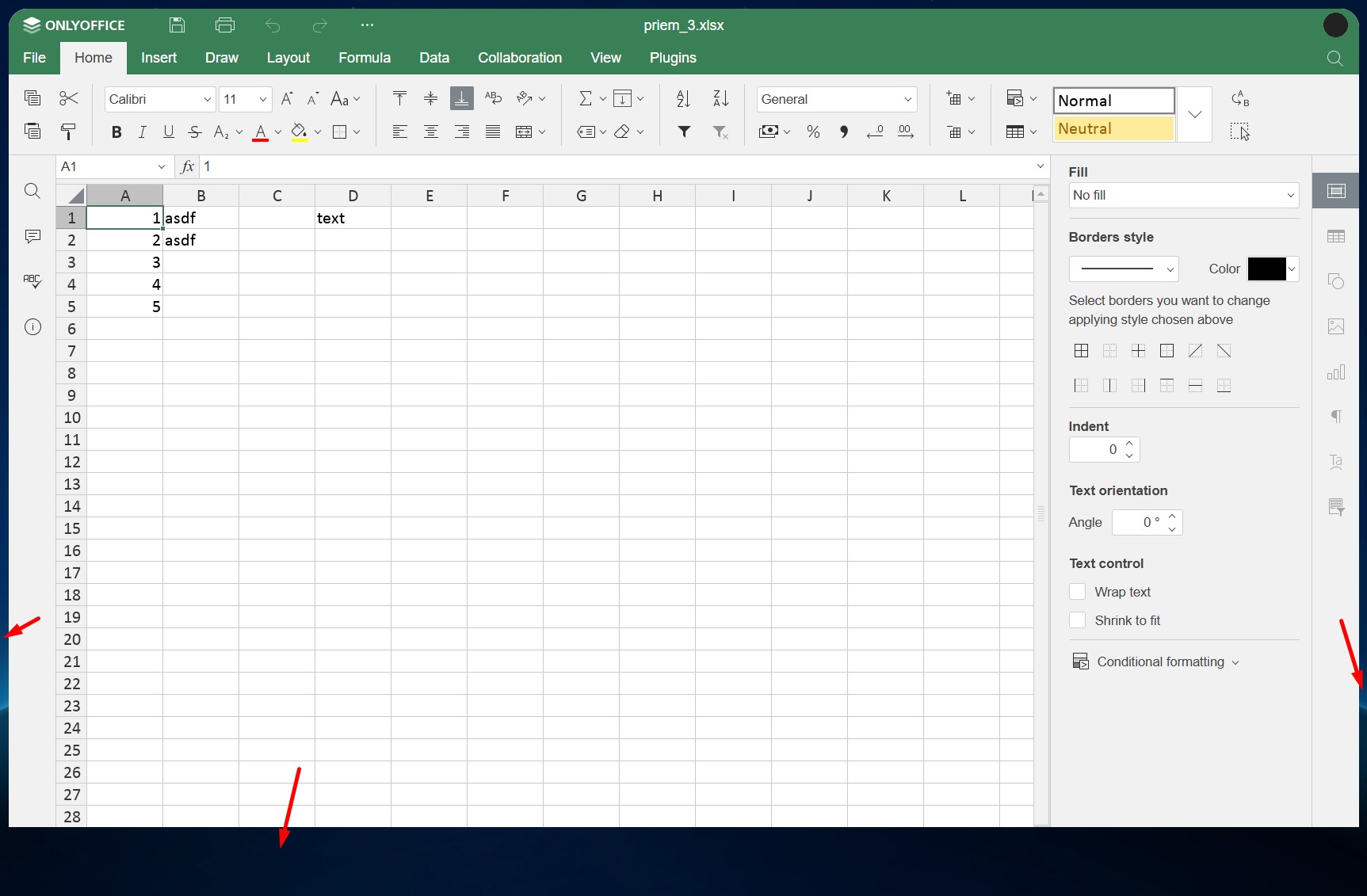

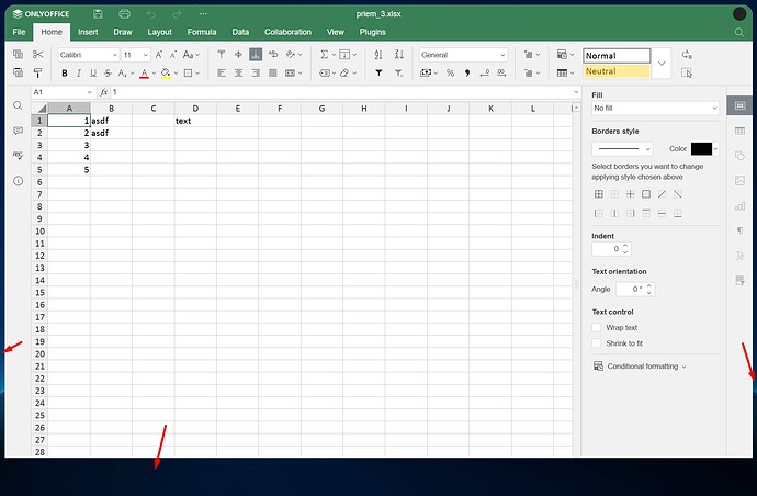

Excel files are not displayed correctly.
There is a frame around the document. Scrolling and tabs are missing at the bottom.
The problem is observed only through a shared link (password access).

On your instance, the style created with this server/core/src/public.ts at master · nextcloud/server · GitHub is not available and this is what causes the issue. You can install Nextcloud in a test environment and search for the style in the Elements tab of the browser dev tools (press Ctrl+F after opening the tab and search for --footer-hight) - this style should be available even without enabling the ONLYOFFICE app, like on the screenshot below:
When the ONLYOFFICE app is enabled, the style must look like this:
<body id="body-public" data-themes="" class="onlyoffice-inline" style="--footer-height: 0px;">
and in your case it looks like this
<body id="body-public" data-themes="" class="onlyoffice-inline">
I’d recommend contacting the Nextcloud support to check what may cause the style being formed incorrectly.
