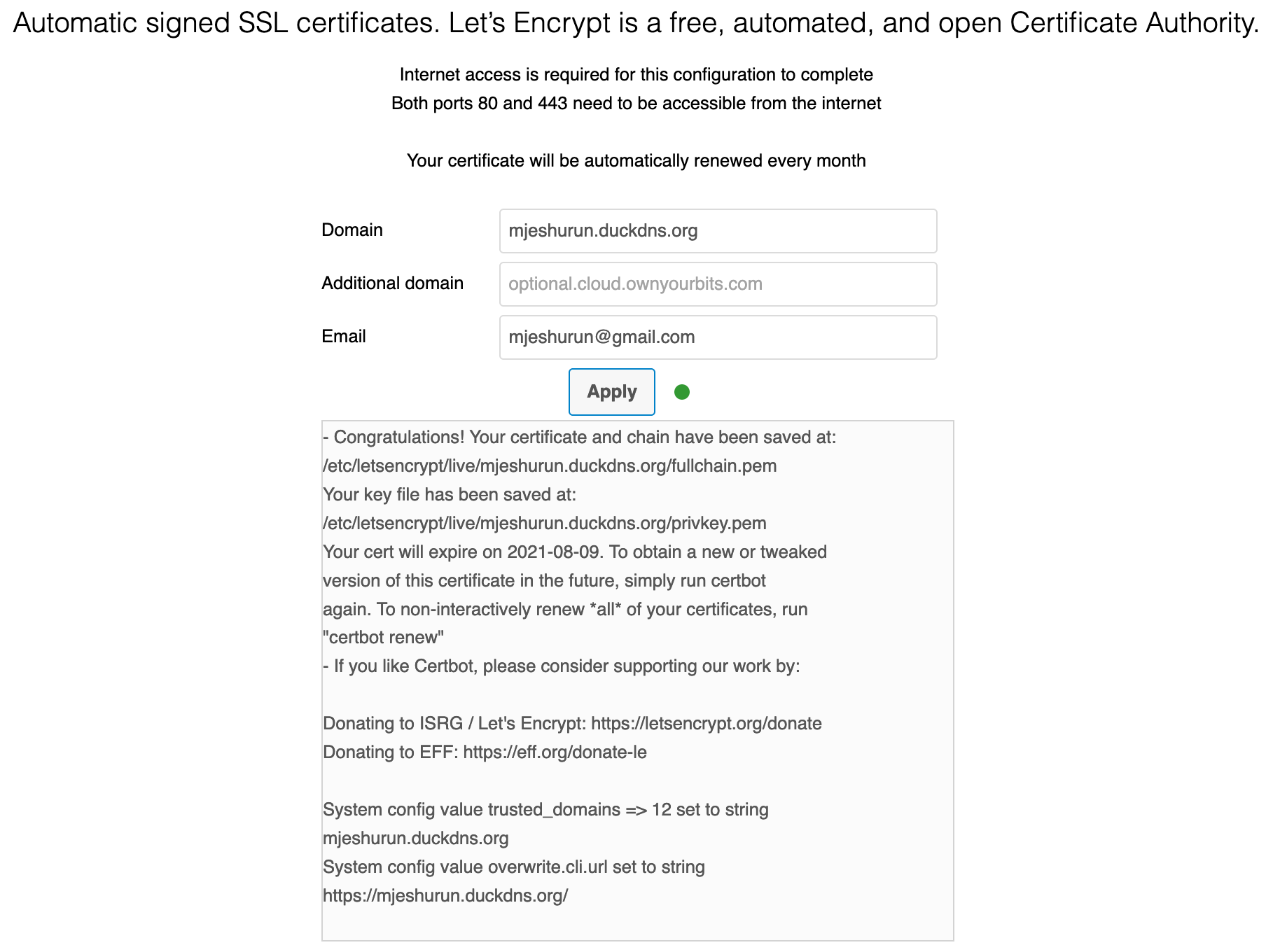

I was able to follow the guide you shared and now my NCP panel shows letsencrypt with a checkmark (:heavy_check_mark:) next to it. I assume it’s a good sign :slight_smile:

Due to the errors I was facing, I decided to re-run the letsencrypt process for DuckDNS within NextCloudPi.
To do that, I started from scratch using NextCloudPi’s webui panel:

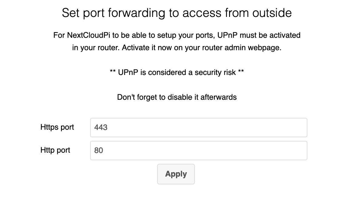

  1. used nc-forward-ports to automatically configure my router’s port mapping. Https was set to 443, and Http was set to 80. It worked ok and the mapping is shown on my router’s admin console.
  1. set nc-trusted-domains as follows:
    Trusted Domain #1 was set to my DuckDNS subdomain (mjeshurun.duckdns.org)
    Trusted Domain #3 was set to 192.168.1.2 (my Raspberry Pi 4 internal IP address).
  2. activated duckDNS using the subdomain I created on DuckDNS and the token it gave me.
  3. activated dnsmasq using my DuckDNS domain address, I left DNS server as 8.8.8.8, and I set the cache size to 1000.
  4. ran letsencrypt within NCP and it finished properly showing a green light.

Maybe your ISP router does not allow UPnP, better log in to your ISP device and check if ports are forwarded.
Thanks again, @OliverV, for your help.
My router supports UPnP and the two ports are open and forwarded to my Raspberry Pi’s internal IP address. Both screenshots are from my router’s admin console:
I tried using the duckdns address without the port number (:443), but I’m still seeing the “Unable to connect” message.
