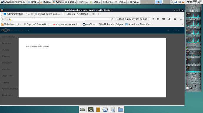

Hello,
i installed nextcloud 10.0.1 on a new server and get on all Pages the Error “This content failed to load”. When i click outside the error-box it seems OK.
I was not be able to install Calendar and Contacts.
Are there any hints.
with regards
Markus

Can you post your Nginx configuration. I recall having this issue on an older ownCloud release and it was due to my Nginx configuration at the time.
Here is my nginx config:

The hint with nginx.conf was good, i could solve the Problem with the following nginx.conf o found on then internet:
