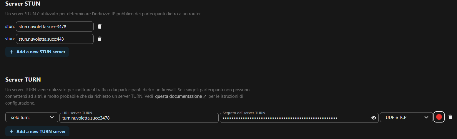

What I tried so far on HPB container (outside docker shell):
compose.yaml
Apache2 configuration on HPB container:
ufw allow 3478/tcp
ufw allow 3478/udp
docker compose up -d
docker compose logs
https://bin.disroot.org/?1784fa6a670572f8#BJctbThRKJSCSAiCPftawsrXQe2vtxrGBddBVfUxAG6Q

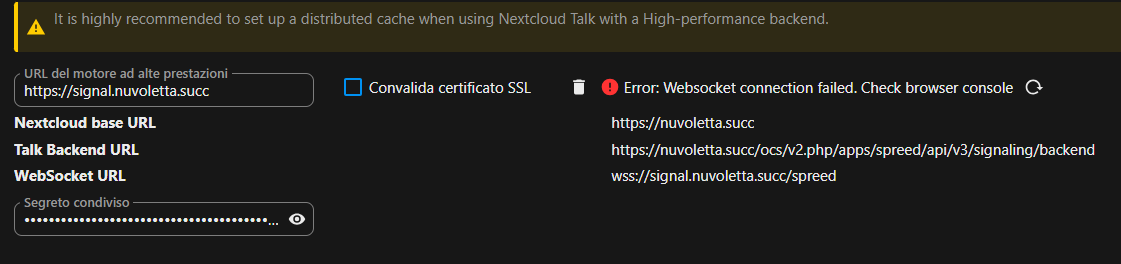

Hello, I’ve left encryption out honestly because I thought about making it work first and then add it later on, didn’t read it was an hard requirement (my instance is just for test and is not publicly exposed).

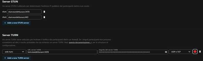

About proxy isn’t these lines of HPB Apache2 config relevant?
ServerName signal.nuvoletta.succ
ProxyPass / http://192.168.2.140:8181/ upgrade=websocket
RequestHeader set X-Forwarded-Proto expr=%{REQUEST_SCHEME}
RequestHeader set X-Real-IP expr=%{REMOTE_ADDR}
If not, can it be achieved with Apache2 or should I install NGINX?

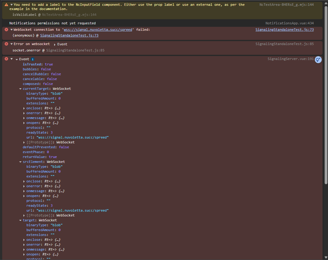

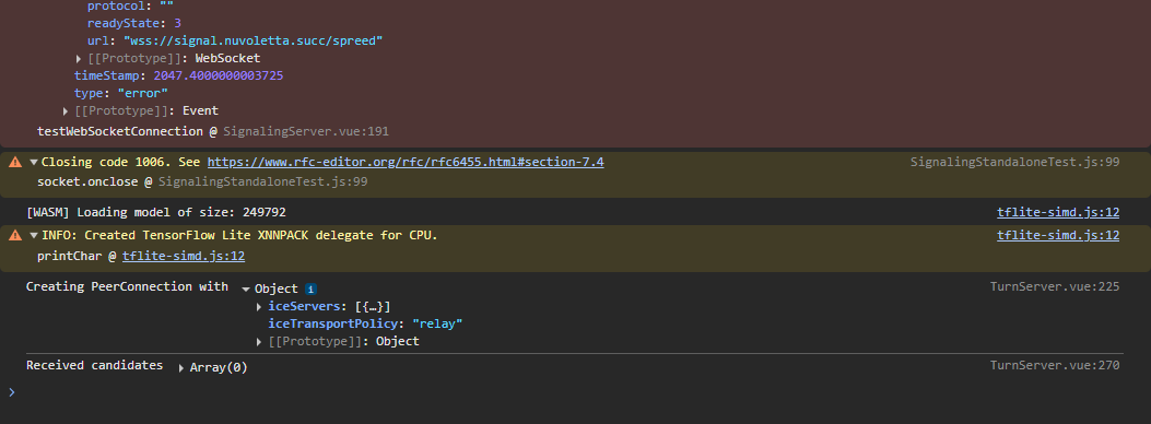

Hello, I’ve changed my Apache2 config as foolows:
<VirtualHost *:443>
        ServerAdmin webmaster@localhost
        # Enable proxying Websocket requests to the standalone signaling server.
        ProxyPass "/standalone-signaling/"  "ws://127.0.0.1:8080/"
        RequestHeader set X-Real-IP %{REMOTE_ADDR}s
        RewriteEngine On
        # Websocket connections from the clients.
        RewriteRule ^/standalone-signaling/spreed/$ - [L]
        # Backend connections from Nextcloud.
        RewriteRule ^/standalone-signaling/api/(.*) http://127.0.0.1:8080/api/$1 [L,P]
        ErrorLog ${APACHE_LOG_DIR}/error.log
        CustomLog ${APACHE_LOG_DIR}/access.log combined
        SSLEngine on
        SSLCertificateFile      /etc/ssl/certs/ssl-cert-snakeoil.pem
        SSLCertificateKeyFile   /etc/ssl/private/ssl-cert-snakeoil.key
Now instead of previous error in Talk settings webpage, I get ā€œError: server response 404ā€.
